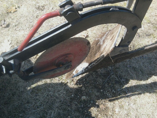

stratostar250 934 #1 Posted April 6, 2014 That's some fun stuff! I plan on making a garden this year. I'll be honest, I don't have all that much of an idea on what I am doing I'd just say don't take any pointers or examples from me! , but hey, we all have to start some where! I got some video and some pictures. I'll upload some pics here at a later date, but here's the video(s) that my dad shot of me! Hope you all enjoy! 4 Share this post Link to post Share on other sites
AMC RULES 37,260 #2 Posted April 6, 2014 Enjoyed your video, and the disclaimer. Thanks to you and Dad for sharing it. 1 Share this post Link to post Share on other sites
WH nut 553 #3 Posted April 6, 2014 (edited) The most fun you can have with your clothes on You need to set your coulter wheel just in front of the shovel so it will cut the sod before it rolls over Edited April 6, 2014 by WH nut 1 Share this post Link to post Share on other sites
stratostar250 934 #4 Posted April 6, 2014 The most fun you can have with your clothes on You need to set your coulter wheel just in front of the shovel so it will cut the sod before it rolls over It was really a bunch of fun! Thanks for the info on the coulter. I knew that it should be straight, but most of the bolts on the plow, sadly, are rusted together, and so almost none of the adjustments are useable until I somehow free them up. We kicked the coulter wheel out like that, just because its adjustment is loose and dirt and sod was just kinda pushing the wheel around, also pushing it inward, and it was just kinda gathering the dirt in one clump . So thats why it was out to the side like that. There were a couple points where it definetly would have helped though! Thanks! Share this post Link to post Share on other sites
C-101plowerpower 1,606 #5 Posted April 6, 2014 (edited) nice vid, maybe next time you go plowing sand the mouldboard first so it nice and shiny bare metal, the soil will roll better that way, and maybe go a bit slower oh and next time start in the middle and work round. Koen Edited April 6, 2014 by C-101plowerpower 2 Share this post Link to post Share on other sites
KC9KAS 4,746 #6 Posted April 6, 2014 You got the job done! All in all the garden looks good! I plowed for the 1st time last year, and I learned that tire chains really make a difference for traction. You may need additional weight too. Free up the plow adjustments and that may help keep the plow down in the ground. I have been looking for a disc....lucky you! 1 Share this post Link to post Share on other sites

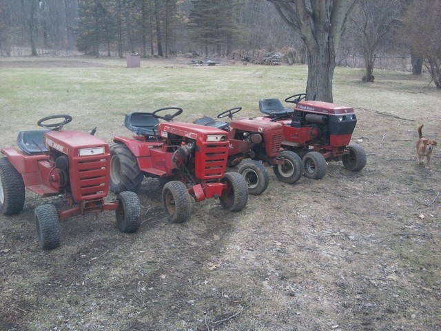

WH nut 553 #7 Posted April 6, 2014 Here is a picture, I had a few of my kids out today 1 Share this post Link to post Share on other sites

stratostar250 934 #9 Posted April 6, 2014 You got the job done! All in all the garden looks good! I plowed for the 1st time last year, and I learned that tire chains really make a difference for traction. You may need additional weight too. Free up the plow adjustments and that may help keep the plow down in the ground. I have been looking for a disc....lucky you! If you are looking for a disk, I don't know if you are looking for a new or used one, but the one that I got, I got from sears, online, on sale around $160. The online sale is on for another month, (I think) and I feel that they are at absolute BOTTOM price I see used ones going for more. And you can get it shipped to your closest Sears store for free so you don't need to pay shipping! I am not sure if they have a massive stockpile of them and are trying to get rid of them, or what, because I feel that normally I can find very decent prices on around the internet, and this is about $40-50 less than anywhere, for a new one! If anyone reads this, and wants a disk harrow, don't wait, unless I am wrong and that isn't a good price. But none the less, thats my Share this post Link to post Share on other sites

squonk 48,322 #11 Posted April 7, 2014 (edited) Plowing a back yard for the first time is tough. Tree roots and what not. Go slower, get some AG's and fill them with fluid. And hang some suitcase weights off of the front did you set the plow up before using it?. This manual will show you how to set up the plow. http://www.brinly.com/graphics/manuals/PP_51BH.pdf Edited April 7, 2014 by squonk 2 Share this post Link to post Share on other sites
