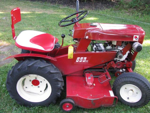

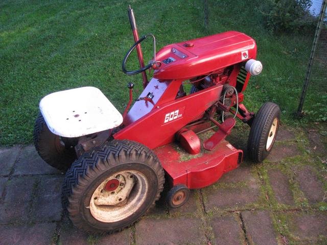

AMC RULES 37,259 #7 Posted April 6, 2014 Here's a couple awesome 1963... non Kohler powered, round hood mowers here. 1 Share this post Link to post Share on other sites

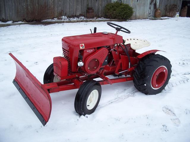

Kelly 1,038 #10 Posted April 6, 2014 Havn't mowed with it yet but I built a round hood from parts, basicly a 753 but has a NEW 8hp in it, it plows and blows snow good, pulls the roller with ease, hope this year to get the 36" deck finished up took about 5 decks to find good parts. Here it is in winter gear 2 Share this post Link to post Share on other sites
WH nut 553 #11 Posted April 6, 2014 Havn't mowed with it yet but I built a round hood from parts, basicly a 753 but has a NEW 8hp in it, it plows and blows snow good, pulls the roller with ease, hope this year to get the 36" deck finished up took about 5 decks to find good parts. Here it is in winter gear 100_3513.JPG Come on Kelly, your snow is gone ( for now) 1 Share this post Link to post Share on other sites
