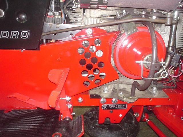

varosd 1,185 #2 Posted April 4, 2014 Here is a mod done by Jay in NC. It works great on my 520 and would like to do one for the 416. some folks have just taken a bimetal hole saw and gone to town! 1 Share this post Link to post Share on other sites

Theroundhousernr 589 #4 Posted April 4, 2014 Hey Don, thanks for the photo. I love that mod and I have been trying to contact Jay to see if he has any of those guards or if I sent him mine , would he get me fixed up? No luck in getting a response. Is this something he has shyed away from? Thanks Kyle 1 Share this post Link to post Share on other sites

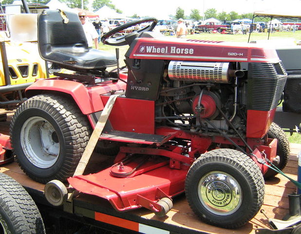

Ed Kennell 47,811 #5 Posted April 4, 2014 Not high tech, but my vented belt guard really throws some heat. I plan to box it into the cab next winter. This is what I found under the tin on my 1988 520H. 1 Share this post Link to post Share on other sites

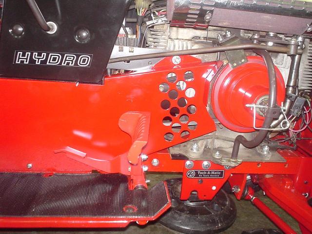

cleat 9,405 #8 Posted April 5, 2014 This is my guard on one of my 520's. I will do the other one soon. Cleat Share this post Link to post Share on other sites
