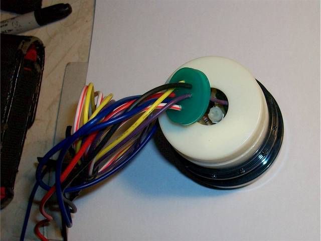

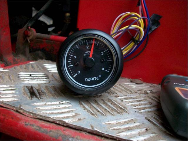

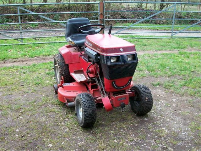

wheeledhorseman 579 #1 Posted April 2, 2014 Whenever tachometers get mentioned there seems to be a lot of interest. Recently Mark (meadowfield) showed that it's possible to modify an existing standard one. Having some understanding of electronics and having been known to design and build circuits from time to time, I too have been thinking of having a go myself for quite a while now. Fine for me, but not much use to others, and the reality is that making them for others would be a very time consuming thing to enter into. It occurred to me that there must be another way that others can do easily if it works. So a while back I purchased a universal marine tachometer made by Durite here in the UK. Cost me just under £50 for a 52mm guage that's very nicely made and water resistant. A bit of a gamble but in the end there's no other way to be sure. 'formariz' made this comment in another thread about regulators.... There are at least a couple members here that seem to be knowledgeable enough to accomplish that. The same goes for modifying an analogue tachometer to be used on Kohlers. Probably would be a bit expensive but I think many of us would appreciate and use those services. so I thought oops, I really must find time to try out my Durite tacho - happened today. I bought it for my 316 so it was a case of will it work with an Onan. You need to have something like the digital hand held tacho on the right to be able to set up a 'universal' tacho like the Durite. Mine is a really cheap one off ebay that I bought to set up the idle and governor on the first Kohler I rebuilt - it's been an invaluable thing to have ever since. You stick a piece of reflective tape on a rotating part, aim the laser at that part when it's spinning, press a button and hey presto, a digital readout. (sorry no pic but only one pair of hands today). There's a whole bunch of wires come out of the back of the tacho. One's for powering it on a 24 volt system, one's for the LED back light, and one is apparently 'not used' but it must have a use at the factory I guess. I only needed to use the other three for a test and it only took a couple of minutes to hook it up to the battery and one wire to the voltage regulator. It worked (once I'd found the right one of the pair of wires from the alternator) For some reason the first one I tried gave a reading but as engine revs decreased the tacho reading increased. In the photo the wire is connected to the rear most tag - the one that worked correctly. The initial reading was high compared to the hand held tacho's reference so it was a matter of adjusting the Durite to match. To do this you remove the sealing grommet at the back and inside there's a little trimming pot to adjust. It covers a wide range so turning it a small amount makes a big difference to the reading. Adjusting it gently is the order of the day with a little cross head screwdiver that fits. I checked it at different revs vs the digital one and all seemed good - happy horseman and happy horse! (don't know why but he always seems to be happy) Could have left it there and got on with making a new dash panel to take three dials for the 316 but I knew you'd kill me for not trying it out on a Kohler. Didn't really want to go through calibrating it again on another engine (only kidding) so...... Sorry about needing to use flash but it was at the back of the queue in the barn. Yes it works and it didn't need recalibrating so I guess there's the same number of coils & magnets to an alternator on an Onan Performer and a K301 that has the complete set of stator coils and magnets. I didn't do a full check so it might have needed a small tweak but it WORKS! Don't ask which of the two wires from the alternator I connected it to, they're both the same colour and it worked with the first one I tried. I was kind of 95%+ sure it would work as these are 'universal' and have to be able to work with almost anything from a Mercruiser with standard external alternator to outboards where it's inside the flywheel like a GT. This particular marine tacho also had a 0 - 4000 rpm scale, bonus! So all I can say is that it worked for me on a 16 hp Onan and a 12 hp Kohler with full set of coils on the stator. It should work for the rest of the engines in the same ranges but I don't have other engines to test other than a 10 hp Kohler. Will any make of tacho work? I hear you ask. I don't know if the Durite range is available in the US but I'd hazard a guess that a similar 'universal' marine tachometer that's adjustable and made by a reputable manufacturer should work. I've used the Durite 052510 product that's a 52 mm (standard meter size like the voltmeter and hours meter on the 316) and 0 - 4000 scale . They also do a bigger 85mm model with 0 - 4000 scale for those who suffer dashboad envy. The one I've used is 80mm deep, not sure about the bigger dial one. The full range can be found here http://www.durite.co.uk/pdf/2012/5/05.6_Equipment_and_Accessories-Dashboard_gauges_Automotive_and_Marine_and_Accessories.pdf I could have gone for something cheaper from China that claimed to be universal and wasn't or that needed adapting in various ways but at the end of the day just under £50 for one that's water resistant, made by a well known manufacturer and carries a warranty was to my mind a good deal. If you decide to take the plunge with other makes please do report back to this thread - stuff gets easily lost on RS as time passes. At the end of the day this worked for me today when I tried it - that's all I can guarantee. Hope others find this useful. Andy 4 Share this post Link to post Share on other sites

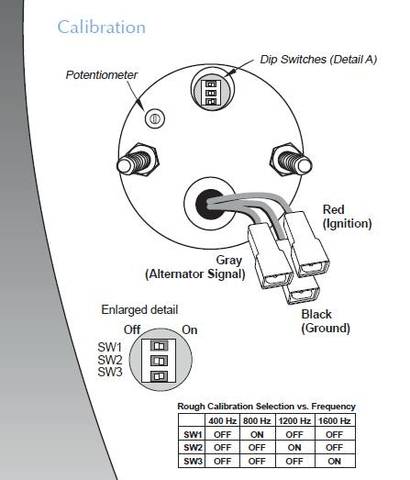

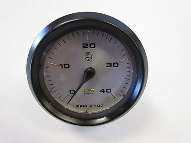

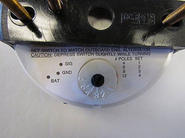

formariz 12,381 #4 Posted April 3, 2014 (edited) Upon reading this post I did a bit of searching and did find some marine tachometers made here, used I believe, and not too expensive with the right scale. Also they only have 3 connections those being, battery, ground,and signal. Some can also be programed for the number of poles in the flywheel, or number of teeth. Since only two wires come from the alternater inside flywheel on a battery ignition motor, both with AC current either wire should work. One assumes then that all is needed is to tap into one of the two wires. My concern is if there is any possibility of damaging stator while attempting this. Edited April 3, 2014 by formariz Share this post Link to post Share on other sites

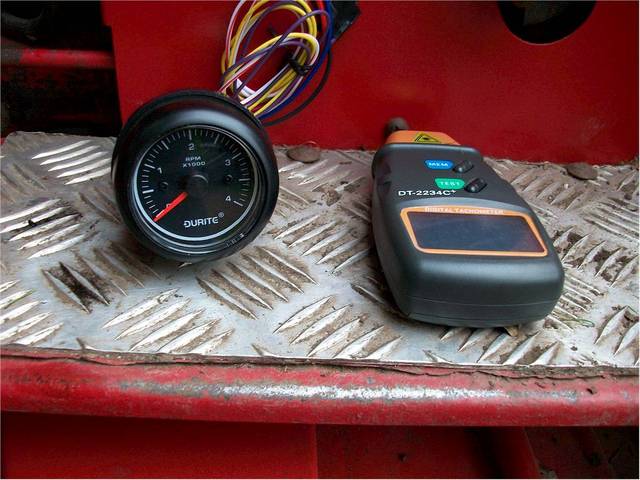

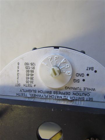

wheeledhorseman 579 #5 Posted April 3, 2014 There is a difference between the type you've shown here and the type I used formariz. Here you have a tacho that is adjustable via one of six switch settings so that it covers a range of different applications, probably most. It could well be that one of these switch settings will give the readout required from a Kohler or Onan but I wasn't going to chance it. This type of tacho doesn't need calibrating against a hand held one - it's factory calibrated but there are just the six preset settings are available. (I think meadowfield and SOI worked out how many 'poles' there are to a Kohler alternator) The type I used (and meadowfield for that matter I think) are truly universal in that the adjustment is continuously variable rather than limited to just six precise settings. The disadvantage is that you need the hand held tacho to calibrate it accurately. If you think you can judge the tickover speed of your tractor by ear then you could use that method. I went for the type that I was pretty much certain would work rather than the type which might work. Anyone out there tried one of these? On the matter of your other concern, electronic tachometers work by sensing pulses from the stator coils, any current they draw from the stator is truly microscopic and will not affect its charging operation in any way. As long as the connection of the sensing wire is not bodged in such a way that it could end up creating a short circuit i.e. the cable is routed sensibly away from heat or moving parts where the insulation could become damaged then you should have no issues. Andy Share this post Link to post Share on other sites

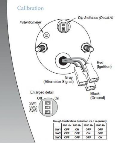

formariz 12,381 #6 Posted April 3, 2014 (edited) I understand. It may or may not read accurately in one of positions, but there will be no fine adjustment to make it 100% correct. Found this other one which I believe has such adjustment. I am not sure of cost. Durites seem to be only available from there and they are picey being well over $100.00 with shipping. infosheet-fp-001-0033_B_Variable-Freq-Tach.pdf Edited April 3, 2014 by formariz Share this post Link to post Share on other sites
wheeledhorseman 579 #7 Posted April 3, 2014 When I was looking for one of these I spent hours trawling the net and trying to make sense of manufacturers' and vendors' technical descriptions, all of which seem to come at it from a different angle. I've checked back on the thread by Mark (meadowfield) which he confirmed that the 15 amp alternator on a Kohler acts as a nine pole producing nine alternating cycles per crankshaft revolution. Looking back at the first tacho you posted (with the white face) the nearest setting on the back is for an 8 pole. It would work but the reading would be higher than actual as it would be recieving an extra pulse per revolution. I'll leave you to calculate the % error. The Faria in the info sheet link is a nicer looking dial IMHO and pretty versatile but it's difficult to make completre sense of their spec. I understand the frequency bit but in relationship to what? I'm going to make an assumption here that it is for full scale deflection i.e. 4000 rpm. So the Kohler produces 9 cycles per revolution, at 4000 rpm that would be 36,000 cycles a minute (9x4000). In a second that would equate to 36,000 / 60 = 600 hertz. My guess would be that you use either the 400 hertz switch setting tweaked up to 600 Hertz (Hz) by the fine adjustment potentiometer or the 800 Hertz switch setting tweaked down by the fine adjustment. Either way I'm sure they will have made sure that all frequencies between 400-800 Hz are achievable. I hope this helps you. It might be worth contacting Faria to check that my assumption re 'frequency' is true i.e. frequency for full scale deflection (4000 rpm) Andy Share this post Link to post Share on other sites

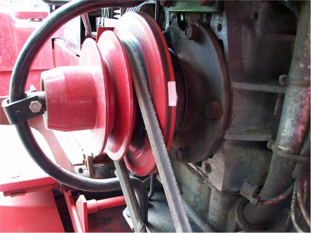

formariz 12,381 #11 Posted April 4, 2014 After a few hours of searching the 2" Faria is nowhere to be found. Found another model but it is 4" and expensive. Incredibly the least expensive one with the best manufacturer description of adjustments is the Durite. It will come out at slightly under $100.00 with shipping. Not only it seems to be a quality item but we know it works so I may just be getting that one. "So my idea is this - stick two bits of reflective tape on the PTO drive (like the one in the picture) but 180 dgrees apart and mount an optical sensor close to it. I've had the components to hand for some time just haven't got round to trying it. If the idea works and you're not bothered about visually having a little sensor that shouldn't really be there then it could just be the solution." Found one company which makes pretty much the above in Canada for farm tractors but with sensor it coats about $300.00+ Share this post Link to post Share on other sites

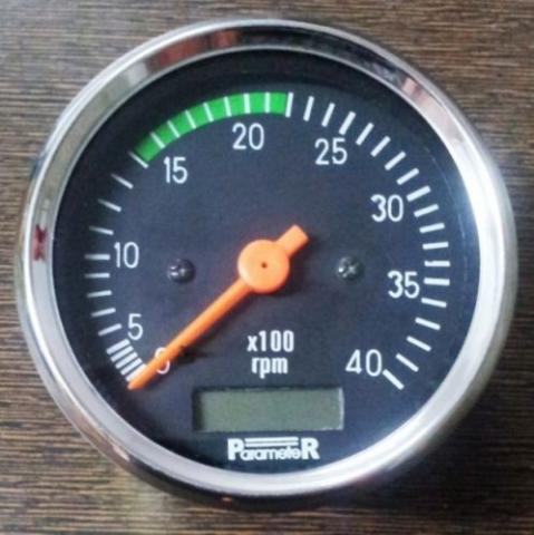

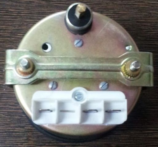

formariz 12,381 #18 Posted April 8, 2014 Came across this one made in India, which seller states that there is some adjustment through little hole in back of it. Rather cheap at $25.00. Share this post Link to post Share on other sites
bmsgaffer 2,071 #19 Posted April 8, 2014 Came across this one made in India, which seller states that there is some adjustment through little hole in back of it. Rather cheap at $25.00. I saw that one, but I am not sure it is water resistant/weather proof, which is a good thing on tractors that may get caught working in the rain. Share this post Link to post Share on other sites
