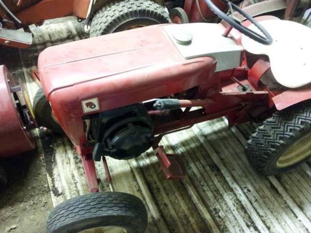

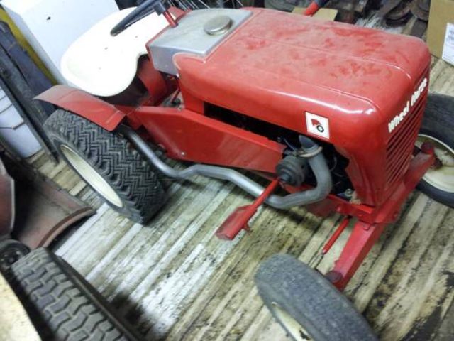

Irish Rover 14 #1 Posted April 2, 2014 I am planning to go look at a 702 for sale in my area. As I'm new to the round hoods, I thought I would post a few pictures an see what you all thought of it. He is asking $600. And claims it needs a new fuel pump. Is this the correct engine? Sent from my iPad using Tapatalk Share this post Link to post Share on other sites
KATO 115 #2 Posted April 2, 2014 Motor should be a Kohler K161S-28622E.... Hard to tell from those pics Nice little tractor ...especially that custom exhaust pipe Share this post Link to post Share on other sites
HorseFixer 2,015 #3 Posted April 2, 2014 And as Kato said the correct engine is a Kohler K161S-28622E whichis electric start and has a delco Starter Gen which tractor is missing the battery and other groceries. For that Kinda money and for what's missing I think I would pass. ~Duke Share this post Link to post Share on other sites

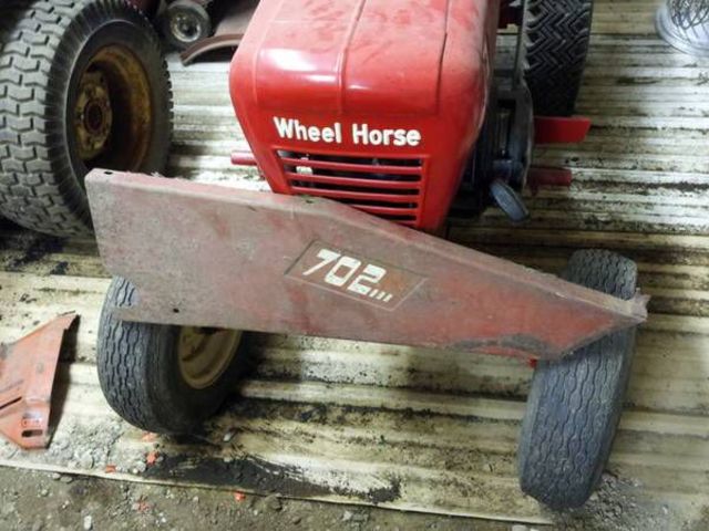

Callen 64 #4 Posted April 2, 2014 The frame and front axle isn't a 702 or from any '62 model. Share this post Link to post Share on other sites
speedyleedy 205 #5 Posted April 2, 2014 Could it be a 633 & not a 702 Share this post Link to post Share on other sites

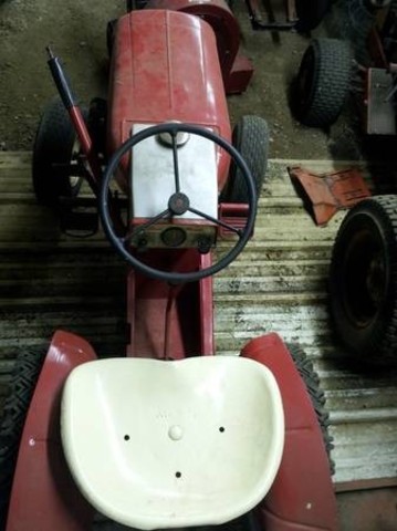

rydogg 186 #13 Posted April 2, 2014 (edited) Steering wheel is 702, gas tank is 1962, front axle is 1963 or newer, clutch/brake pedal is 1963 or newer, engine is not for a 702, seat is nice but incorrect it should be square, missing left side cover near brake band.....I would go $300 tops. Tractor is more 633 than 702 the numbers for a 633 kohler is K141T-29102A but there may be some other spec numbers since the early 633 had a different carb and ignition setup. Edited April 2, 2014 by rydogg Share this post Link to post Share on other sites
Irish Rover 14 #14 Posted April 2, 2014 Awesome. Thank you all for the info. I agree with the prices you guys are posting. I'll see if he is willing to bite. I'm. Looking to buy it for my son. He won't care if it is a bit of a mutt. My understanding is that the 633 was built with parts on hand hence some different pedals an such from one tractor to another. The engine looks correct for the 633 and not the 702. It's amazing how much you can learn quickly on this forum site with the help of you guys. I'm very happy to be on board with all of you. Sent from my iPad using Tapatalk 1 Share this post Link to post Share on other sites
AMC RULES 37,260 #15 Posted April 2, 2014 Obviously was incorrectly pieced together. Share this post Link to post Share on other sites
ri702bill 13,316 #16 Posted April 2, 2014 I agree with Rydogg - and it has the 1962 style 2 position lift stop quadrant, along with the bent straps that go from the hoodstand to the frame at the lower steering support. A few things could tank the deal - the hood has been cut to clear a previous exhaust modification on the right hand side, and you mentioned a plow. Check the frame weldment at the 4 holes where the axle attaches for tearout or repair, and also check the lower cast iron steering support bracket to see that it is not broken. Years of plowing put a lot of stress , twist & vibration into those parts - my 854 had both - the frame is repairable, the bracket is best replaced. You also mentioned a deck, but I do not see the PTO mechanism that pivots on the right side foot rest rod - it may not fit or work properly with that exhaust setup. Bill Share this post Link to post Share on other sites

Kelly 1,038 #20 Posted April 2, 2014 If it runs good I see a $400 machine if everything is in good shape, yes it is a pieced together machine, BUT a good running engine $150 if the hood is nice $75-100, gas tank $40 seat if nice $40 belt guards $30 each, steering wheel if nice $40 list goes on. I see a bunch of stuff from a few years, steering wheel, and belt guard on it with no indent looks to be 701, dash tower, hood (no lip on bottom edge) and fuel tank are 62 parts, frame looks to be a 64 it has a bolt on batt tray, seat looks like a 60 suburban. Share this post Link to post Share on other sites
