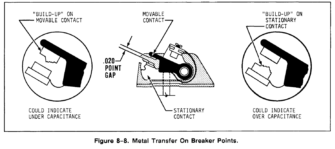

formariz 12,381 #1 Posted March 30, 2014 Usually old points have developed a sharp pointed protusion on one side, and the exact opposite on the opposite side. Does that condition affect timing on engine? If not replacing points, should it be filed flat and timing reworked? Many thanks. Share this post Link to post Share on other sites
rmaynard 17,659 #2 Posted March 30, 2014 I am not at my computer, but the Kohler manual does explain the question that you are asking. Share this post Link to post Share on other sites
oldredrider 2,554 #3 Posted March 30, 2014 File the points flat and re-gap to .019. Replacing the condenser should correct the problem. Share this post Link to post Share on other sites
formariz 12,381 #4 Posted March 30, 2014 File the points flat and re-gap to .019. Replacing the condenser should correct the problem. I thought it was just normal wear did not realized that it is caused by condenser! Share this post Link to post Share on other sites
rmaynard 17,659 #5 Posted March 30, 2014 (edited) Back at my computer where I have access to my Kohler manual. To confirm what Paul said, here is a snapshot from the manual: Edited March 30, 2014 by rmaynard Share this post Link to post Share on other sites
Retired Wrencher 7,043 #6 Posted March 30, 2014 Back at my computer where I have access to my Kohler manual. To confirm what Paul said, here is a snapshot from the manual: points transfer.png Bob what does over or under capacitance mean???? Gary Share this post Link to post Share on other sites
Racinbob 13,290 #7 Posted March 30, 2014 A capacitor stores electrical energy until the points discharge it. Capacitance relates to the amount of electrical energy a given capacitor can store. The term for it is farad. If I recall correctly from working on cars the capacitance rating was stamped on the condenser. Share this post Link to post Share on other sites
rmaynard 17,659 #8 Posted March 30, 2014 (edited) Generally Gary, it means "bad condenser". Edited March 30, 2014 by rmaynard Share this post Link to post Share on other sites
Retired Wrencher 7,043 #9 Posted March 30, 2014 Generally Gary, it means "bad condenser". ok thanks so no build up means good condenser???? Share this post Link to post Share on other sites
pfrederi 21,342 #10 Posted March 30, 2014 ok thanks so no build up means good condenser???? If you have spark and no build up/pitting the answer is yes Share this post Link to post Share on other sites
Ed Kennell 47,950 #11 Posted March 30, 2014 I believe the Kohlers require a 2 microfarad capacitor (condenser). Share this post Link to post Share on other sites
