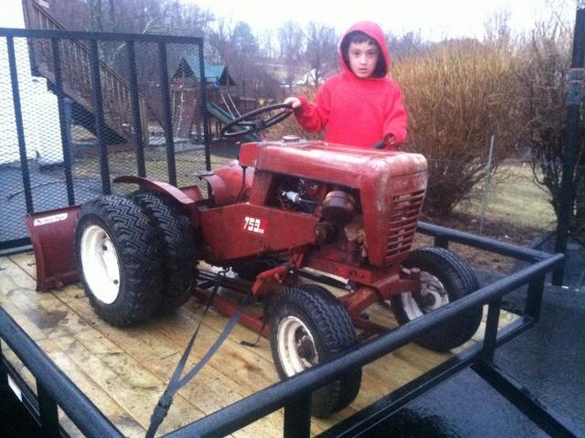

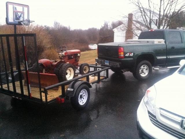

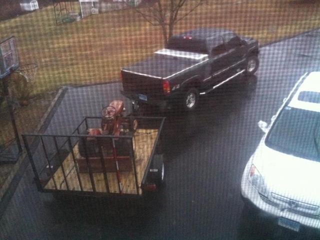

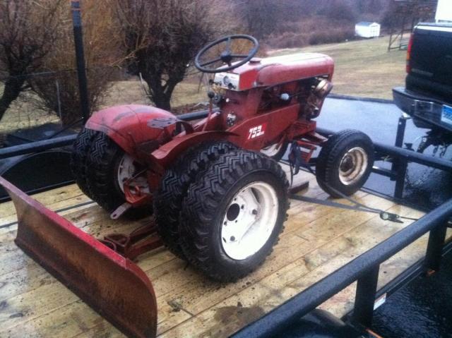

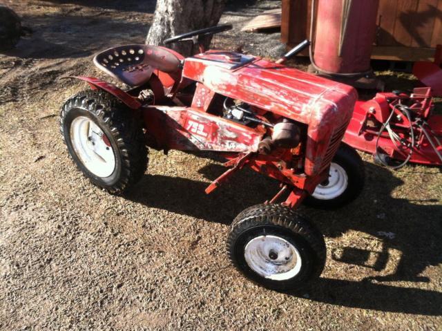

stevebo-(Moderator) 8,742 #1 Posted March 30, 2014 I just got back from picking up this nice little all original, one owner 753. From my understanding this was only used to plow. The carb needs to be cleaned, paint up the wheels, free up the cables, find a new square seat and maybe wet sand to see if I can find the original layer of red....Then I will call her done. The steering it tight and tranny shifts nice with no noises. My son claimed it as his already.... 11 Share this post Link to post Share on other sites

JERSEYHAWG / Glenn 4,590 #11 Posted March 30, 2014 steve, nice grab. I imagine the young gentleman in the sweatshirt is the claiment / owner. Glenn Share this post Link to post Share on other sites
speedyleedy 205 #12 Posted March 30, 2014 Great find Steve Share this post Link to post Share on other sites
neil 2,416 #13 Posted March 30, 2014 She looks a real tidy girl Steve , nice & straight and looking and still has the steering wheel cap , Nice Share this post Link to post Share on other sites
slovinski 42 #14 Posted March 30, 2014 Claimed before the trailer gate dropped....yep its his Share this post Link to post Share on other sites
Hodge71 691 #15 Posted March 30, 2014 What a gorgeous lil machine Steve!!! I am really getting to like th look of duals on these round hoods and those tires make it look Share this post Link to post Share on other sites
jackhammer 553 #16 Posted March 30, 2014 Looks like it couldn't have went to a nicer young fellow Share this post Link to post Share on other sites

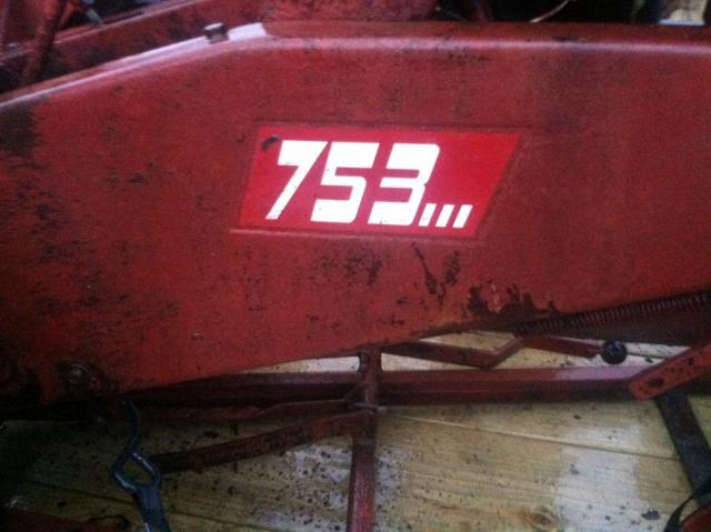

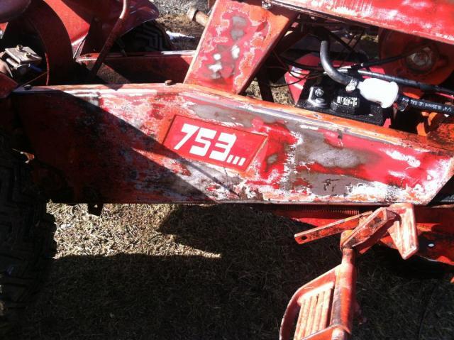

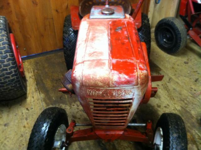

stevebo-(Moderator) 8,742 #17 Posted March 30, 2014 Today I was able to pull the carb off, let it soak in carb cleaner bath for a few hours. Put it back together but would only run with choke partially on. Ended up adjusting hte float and all set. I also replaced the fuel pump as the one in it was non functional and only gravity fed. I was also able to get the choke and throttle cables free. I changed the starter generator belt while I was at it. Gave it a really good bath and my son made me start to wet sand the white paint off the hood. I think the po used a primer on the hood but it came off. Under it was the original orangy red paint. The hood color seems a little different than the other sheet metal so I am not sure how this one will end up. Here is a side by sid eof the old and partially finished wet sand with a little wd to make it shine a little. This also came with one cyclops light mounted to the front grill and i think it will be going back once it is wet sanded. Share this post Link to post Share on other sites

stevebo-(Moderator) 8,742 #23 Posted March 31, 2014 I think this one may have to be restored.... :*****: While wet sanding down to the original red I found that the po sanded many of the areas of the original color red down to bare metal, then primed with a light grey primer and top coated in red. Many of the areas are now bare metal on the tins and it really does not look the way I wanted it to come out. Several months ago I did this with a 702 I picked up but the difference is that tractor was simply primed over the original red so once the primer was sanded down it exposed the original red and it has the right look I wanted. Those of you who know me know that I really dislike repainting an original tractor like this one but I think I have to. I need to think about this one for a while. Share this post Link to post Share on other sites
AMC RULES 37,260 #24 Posted March 31, 2014 (edited) To accumulate some natural patina Steve... just keep the tins wet, and leave 'em sit out in the weather for awhile. Interesting idea here too. Edited March 31, 2014 by AMC RULES 1 Share this post Link to post Share on other sites
stevebo-(Moderator) 8,742 #25 Posted March 31, 2014 I may try that Craig ... Share this post Link to post Share on other sites
