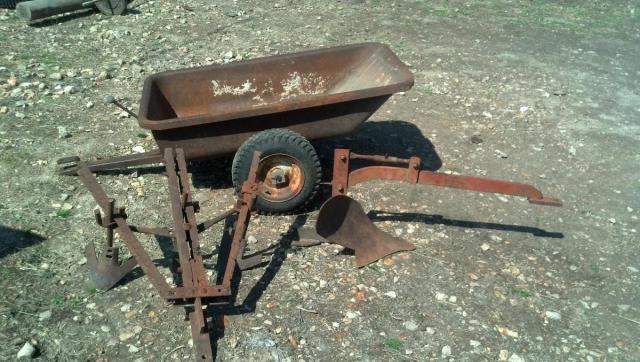

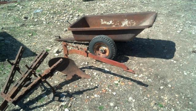

posifour11 723 #1 Posted March 29, 2014 I went to look at a parts mower for a rider I'm fixing up to sell. Came home with these instead. The cart is not rusted through. A bent up rear lip and concrete on the inside in some places. Didn't think anything this old would have made it into Arkansas. Very happy! 5 Share this post Link to post Share on other sites

KC9KAS 4,746 #3 Posted March 30, 2014 Good deal. You know, the tub cart I have seems to have concrete on it too. People must have thought these carts were mobile "mud boxes". Share this post Link to post Share on other sites

neil 2,416 #7 Posted March 30, 2014 Great find , love the patina on that ol tub cart , should look great all oiled up Share this post Link to post Share on other sites
posifour11 723 #8 Posted March 30, 2014 Thanks guys. I'm still stoked. I looked closer at the plow last night and the adjustment screw stuff "may" be rusted together. I'll try the vinegar trick and if that doesn't work, I'll build an e-tank. The bearings in the cart wheels are really noisy, so I'll be greasing them to see if they'll pull through. Share this post Link to post Share on other sites

KC9KAS 4,746 #10 Posted March 30, 2014 I have the same garden plow. I used PB Blaster to loosen the adjuster, unscrew it completely then used a wire brush to clean the threads. Grease it up and reassemble. If I have a problem in the future, I will disassemble, clean and add grease zerts to the turn-buckle. Share this post Link to post Share on other sites

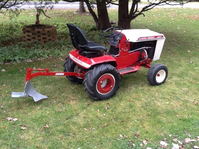

squonk 48,223 #11 Posted March 30, 2014 I have 2 of those plows. 1 is restored for show. the other is in process of a clean up. That one will go into the ground! Share this post Link to post Share on other sites
