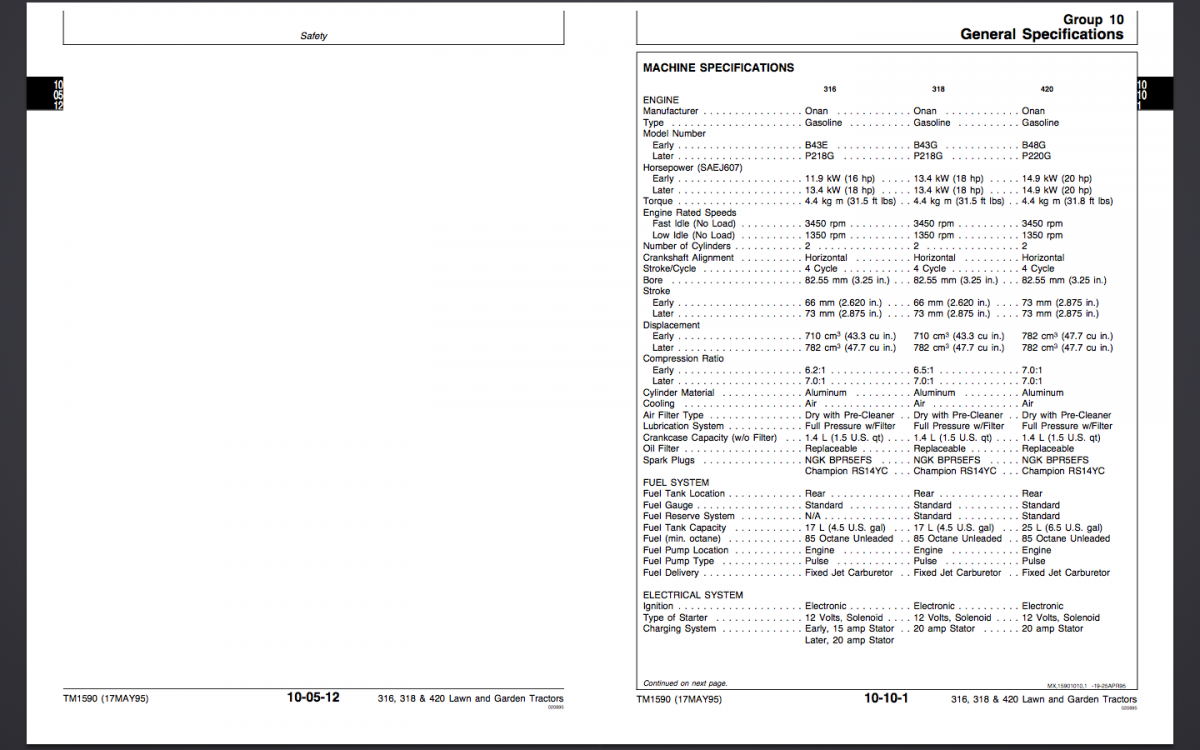

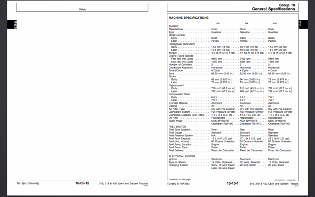

Martin 2,134 #9 Posted March 29, 2014 (edited) there are other differences also between the b and p series engines...... a major one is the move from points to electronic ignition.... heres a summary of some of the differences from early to late (b to p series) from the JD TM1590 manual. this is a JD manual but it still relates to our engines..... in the 316 column you will note that the b43 was replaced by the p218 (not a p216) so the early specs are for the 16 hp engine and the later are for the 18hp (same as the 318 column late engine) just studying that spec sheet for a bit you can pick up the minor differences and similarities between the engines.... Edited March 29, 2014 by Martin 1 Share this post Link to post Share on other sites
