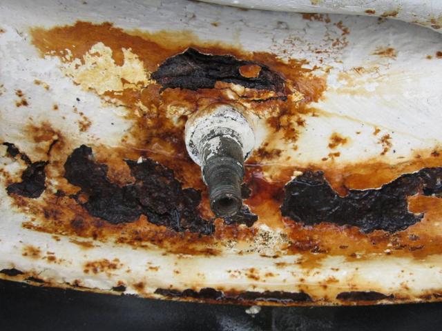

HorseFixer 2,015 #11 Posted March 29, 2014 Since the rubber is bad it needed to come off the rims, The rears were easy to get off but the fronts really puzzled me for a bit. I reached out to a couple senior owners on how the fronts were removed. Then while standing at the sink washing my hands it came to me. Under this flat cap on the front wheel that was depressed all the way into the rim was a brazed on nut on the outer center of this cap through that nut was a 1/4" stove bolt with only a 1/4" of threads that really did nothing other than blocking off this open area from getting dirt in. The brazed on nut however was for a different purpose. thought I bet if I take out that spindley Stove Bolt and crank in a longer bolt it will drive against the axel and push the cap off to gain access to a threaded on axel nut keeping the wheel on like any other tractor. Sometime the obvious is right in front of you.... Is that called Old Age? The rear rims had an inner tube but the chloride inside was leaking through the valve stems which is what was rusting corroding the outside of the rims. ~Duke Share this post Link to post Share on other sites
stevebo-(Moderator) 8,742 #12 Posted March 29, 2014 Duke- Do you think there is anyway to save the rear rims? Maybe some sort of filler like a jb weld or other?? 2 Share this post Link to post Share on other sites
Jake Kuhn 1,600 #13 Posted March 30, 2014 Looks like your off to a good start duke, love watching your resto threads! 1 Share this post Link to post Share on other sites
Desko 686 #14 Posted March 30, 2014 This is a good candidate for a resto I have never seen a SR wheel horse before. For the rims you might have to cut out where the steam goes drill it out and weld another piece in if there's enough metal left. 1 Share this post Link to post Share on other sites

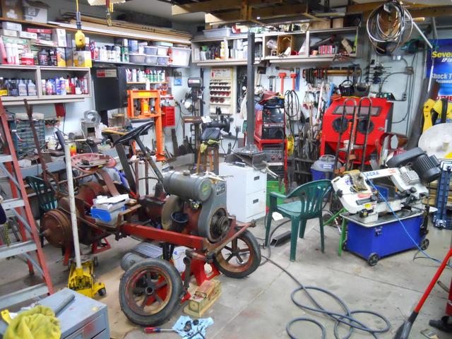

neil 2,416 #15 Posted March 30, 2014 That is a real shame about those Rims , I agree with SteveBo , from the pics that we see they almost look salvagable . Duke , This pic of the senior on your workshop is just awesome , reminds me of how it must have been back in 1955 when Cecil was building these tractors in his Garage . Also looks like a Hospital operating theatre. 1 Share this post Link to post Share on other sites
JERSEYHAWG / Glenn 4,590 #16 Posted March 30, 2014 Duke, cant wait till its finished all ready. In all her glory. Glenn 1 Share this post Link to post Share on other sites
HorseFixer 2,015 #17 Posted March 30, 2014 (edited) Duke- Do you think there is anyway to save the rear rims? Maybe some sort of filler like a jb weld or other?? Damn Chloride That stuff really knows how to muck up a tractor! Well stevebo I figure after I get the fronts off I would take them all over to Brian My Master Blaster Buddy and let him do his thing and see how bad they are. I know they make some glass or puttys that can go on and if any Body shop guys want to chime in and tell me what's available please do. Jake ask yer dad what he thinks? That is a real shame about those Rims , I agree with SteveBo , from the pics that we see they almost look salvagable . Duke , This pic of the senior on your workshop is just awesome , reminds me of how it must have been back in 1955 when Cecil was building these tractors in his Garage . Also looks like a Hospital operating theatre. DSCN6398.jpg Thanks Neil, I'm fixin to go out and turn on the furnace as it got down to 26 deg last night. I then plan on doing a photo shoot on the ole girl taking a zillion pictures as reference like I do on any resto before I start to take things apart. Neil, Per your comment She does look pretty good in that shop if I do say so myself! Maybe this afternoon I will crack open a Cold one sit back in that plastic Lawn Chair and admire her! Below Is My Buddy Brian the Master Blaster and His Shop. He Has 4 of these Building's And I Ran The Air Lines Between Them Years Ago. He was Blasting My RJ-56 in these pics, Sure is good having Blokes like this. You can bet when he calls me for anything I am there! ~Duke Edited March 30, 2014 by HorseFixer Share this post Link to post Share on other sites

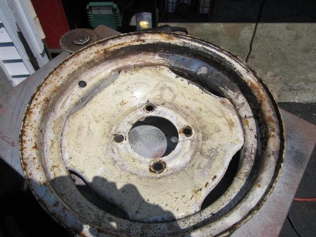

HorseFixer 2,015 #22 Posted April 1, 2014 Tonight I removed the second front rim and then demounted the tires. I took them over to my Pal's Brian's Shop And the MASTER BLASTER gave them a blast from the past. The two fronts came out beautiful the rears were a different story. One of the rims will need a WHOLE LOTTA LOVIN to bring it back. I will need to love it real good with the tig welder, then I'm gonna love it real good with Some Lab Metal. All I can say is there is gonna be a whole lotta lovin going on over at the Duke's Place. Here's some pic's of the Master Blaster at work and the rims. ~Duke LAB METAL LINK BELOW 2 Share this post Link to post Share on other sites
neil 2,416 #23 Posted April 1, 2014 Bob, Hmmm the bottom rim looks quite sad but the one above looks salavagable , not teaching you to suck eggs, but could`nt you just weld some steel bands on the inside of the rims to strengthen the rim up then tidy up things on the outside by spot welding then grinding back to shape???? the strength will be on the inside of the rim and the outside could cosmetically be doctored up , i know this would not be ideal but it may get you by until another rim shows up in the future . Fortunatley these tractors are not high speed tractors so i dont think it would impede on the safety element to much . Still , im sure you know the best way to attack this problem , just though i would chuck a few ideas out there 1 Share this post Link to post Share on other sites
HorseFixer 2,015 #24 Posted April 1, 2014 Neil, Great Minds thinks Alike I Intended to Weld the Holes up and do a little reinforcing in some way. I like your idea maybe Ole Duke will shoot sherbert to her Herbert! Stay Tuned. ~Duke Share this post Link to post Share on other sites

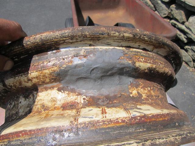

stevebo-(Moderator) 8,742 #25 Posted April 1, 2014 I know this is NOTHING that you would do with this project however this is how I did a repair job on my 953 rim that was rotted around the original valve stem hole.... A little JB weld with a quarter covering the old hole and rust and drilled a new hole in a solid spot then tubed it. 2 Share this post Link to post Share on other sites
