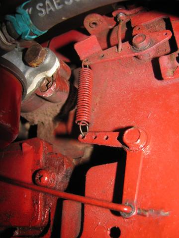

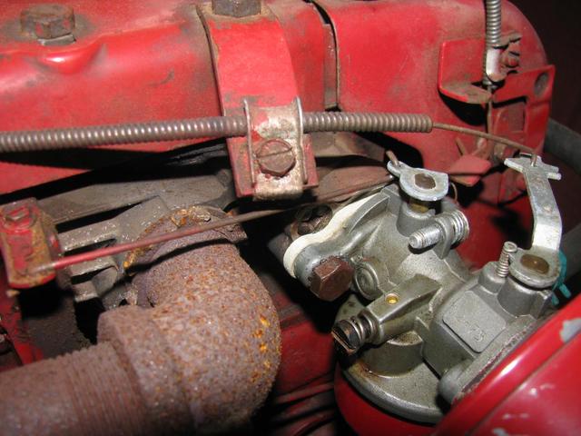

AMC RULES 37,259 #28 Posted March 29, 2014 (edited) Here's a couple Ken, let me know if you need more. Edited March 29, 2014 by AMC RULES Share this post Link to post Share on other sites
Ken B 3,203 #29 Posted March 29, 2014 Thanks Craig! I made up a spring and its running much better now, not Kohler smooth, but better. It starts right up and it idles fine. Like most Tecky's I've owned it does sound like there is a marble or two in it 1 Share this post Link to post Share on other sites

Retired Wrencher 6,831 #31 Posted March 30, 2014 (edited) I grabbed the 603 today. I left work early so I got it home by 2:30 this afternoon First thing I did was 86 the chrome side moldings and give it a bath. Tore the mower deck and homemade rear hitch off. Cleaned the tank, carb, new fuel lines and pulled the flywheel to clean the points. It runs and drives but it runs like any tired Techy I've ever had, dizzy, dazed and a little confused with some smoke but it does run which is more than I expected. I'm not sure what I'm going to do about an engine for this tractor... There is a spring missing on the throttle assembly on the flywheel side of the engine, anyone got a picture of that spring and where it goes? ken Very nice tractor. If you ever think that u are going to change out the engine let me know I am looking for a engine to practice rebuilding. I have a 606 and a 657. I will have a lot of time on my hands soon so I am looking this type of engine to practice with. so I can do over the 606/657 ok Gary B..................... Edited March 30, 2014 by T1257 Share this post Link to post Share on other sites
