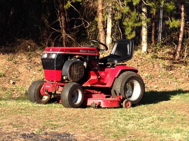

Bert 805 #13 Posted April 14, 2014 This is the 518 I was thinking of putting an 8 speed in, old thread but I'm checking to see if I figured out how to post pics lol 1 Share this post Link to post Share on other sites
