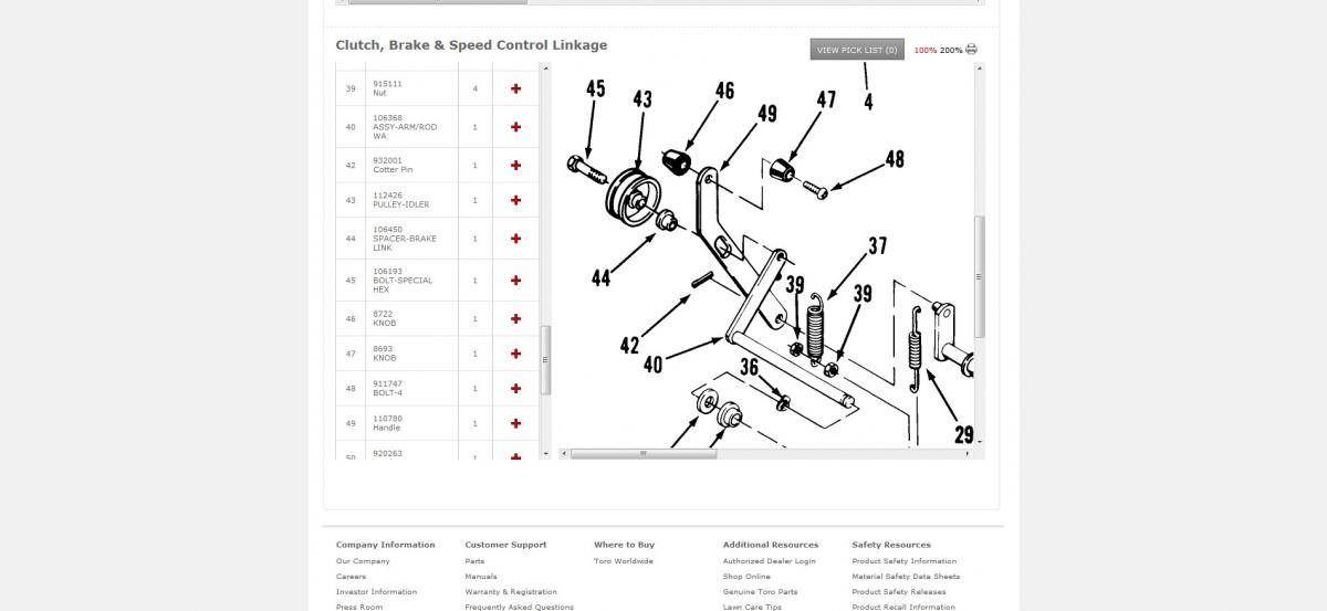

pfrederi 21,095 #5 Posted March 25, 2014 I noticed the same issue must have occurred on my 418A as there is a groove in my hard line also. There is possibility that the spacer on the bolt that holds the idler has worn down (or the slot in the handle the spacer rides in has worn) allowing the idler to move in closer to the frame.) On my 418A the spacer was gone and the slot in the handle was wallowed out. (Spacer is item 44 in diagram) Share this post Link to post Share on other sites
varosd 1,185 #6 Posted March 29, 2014 I noticed the same issue must have occurred on my 418A as there is a groove in my hard line also. There is possibility that the spacer on the bolt that holds the idler has worn down (or the slot in the handle the spacer rides in has worn) allowing the idler to move in closer to the frame.) On my 418A the spacer was gone and the slot in the handle was wallowed out. (Spacer is item 44 in diagram) My Eaton 1100 equipped Workhorse tranny engagement lever (part # 49) had worn out the back of the idler pulley slot and it came up and out of the shifter plate when I pulled up on it! got a used one of sleaze bay and back into operation. not sure why it happened, but like Paul stated, make sure it all wallowed out or like mine missing a chunk o" metal! Share this post Link to post Share on other sites
