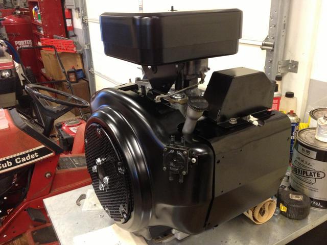

JackC 619 #17 Posted March 18, 2014 The 520HC (C = Commercial) has a larger air filter. They come up for sale on Ebay from time to time. I would go that way before going with a K&N which is probably designed more for air volume than filtering ability. Share this post Link to post Share on other sites
Hodge71 691 #18 Posted March 18, 2014 The 520HC (C = Commercial) has a larger air filter. They come up for sale on Ebay from time to time. I would go that way before going with a K&N which is probably designed more for air volume than filtering ability. 081_4334.jpg 081_4335.jpg Jack that is a gorgeous HC...hope I get one someday... Share this post Link to post Share on other sites
