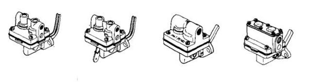

slammer302 2,157 #5 Posted March 14, 2014 The one I have is a 47-393-04 Share this post Link to post Share on other sites
rmaynard 17,447 #6 Posted March 14, 2014 Here are drawings of four of the pumps that Kohler had on their K241 through K341 engines. The 47-393-04 pump is the one on the right according to the Kohler parts diagram. Share this post Link to post Share on other sites
slammer302 2,157 #7 Posted March 14, 2014 Thats what I needed to know I'm just going to put one on it from another motor. The one that is leaking everywhere is the one to the right of the pic Share this post Link to post Share on other sites
