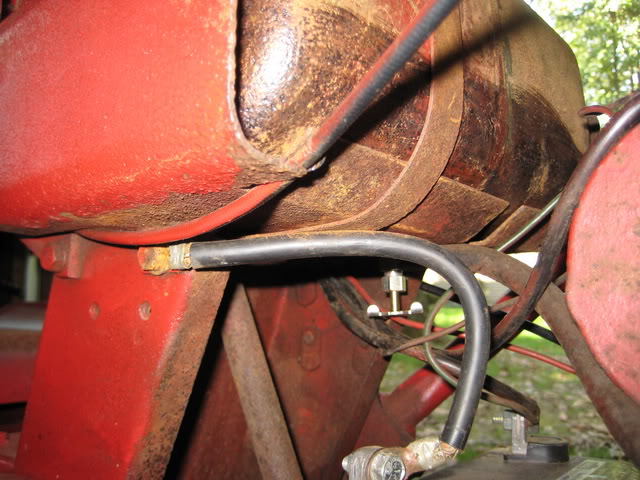

Mr. 856 170 #1 Posted March 12, 2014 If I remember correctly the choke goes through the slot where the tank sits and then down and under the flywheel cover of the engine and then up to the carb. Throttle cable I don't remember. any help fellas? Also have what appears to be a leftover belt guide..........appears to bolt to something. Besides the guide on the clutch pulley what other guides should be in place for the belt? Share this post Link to post Share on other sites

rmaynard 17,428 #5 Posted March 14, 2014 Here is a picture taken of the throttle cable when I had an 856. The cable came through the hole in the tray, under the tray, over the starter and muffler, and attached to the governor. 1 Share this post Link to post Share on other sites
Mr. 856 170 #6 Posted March 14, 2014 yup that helps a ton. Thank you maynard. Didn't the ground wire go the engine? I see yours goes to the frame. Share this post Link to post Share on other sites
rmaynard 17,428 #7 Posted March 15, 2014 That's the way it was when I got it. I moved it to the engine before I sold it. Share this post Link to post Share on other sites
Mr. 856 170 #8 Posted March 15, 2014 ah ha I see. guess it wouldn't matter where it would go along as its grounded. Thanks again. Share this post Link to post Share on other sites
