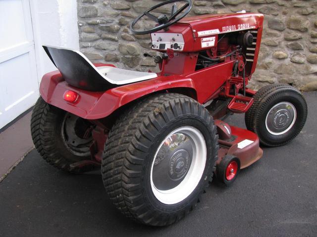

boovuc 1,090 #2 Posted March 11, 2014 Let me make a suggestion...............The round hoods are getting harder to find as a project tractor without crossing into basket case territory. If you can find one, great. For a short frame project tractor that parts are very easy to get yet has a very classic look, try to find an "867". This is a 1967 8 HP short frame that was very plentiful. Many parts are interchangeable with other tractors from that era as well. You won't have trouble finding one and you won't spend a lot of money for it. This is mine. It still needs a dash panel refurb, the original seat needs installed, etc. etc. but you get the idea of how they look. And they are very easy to work on. They also are great workers. I still use mine a hand full of times each summer to mow. Mine is more to look at than to work. They also have a "cigar lighter" standard! You can't beat that! 3 Share this post Link to post Share on other sites

bmsgaffer 2,071 #5 Posted March 12, 2014 (edited) Thanks for the suggestion, that is the kind of think I am looking for. Small but plentiful. Are there others in that era or is the 867 the most plentiful? I am assuming anything with a '7' at the end for 1967? Did you put wider wheels on the back of yours? Edited March 12, 2014 by bmsgaffer Share this post Link to post Share on other sites
Ken B 3,203 #6 Posted March 12, 2014 Yes the 7 does identify it as a 67. It does look as though boovuc put wider rims and tires on his 867. If you look thru the Wheel Horse picture gallery you can look thru all the different models so you can get an idea of what you like and what to look for. I'd recommend a model with a Kohler engine on it with electric start. Share this post Link to post Share on other sites

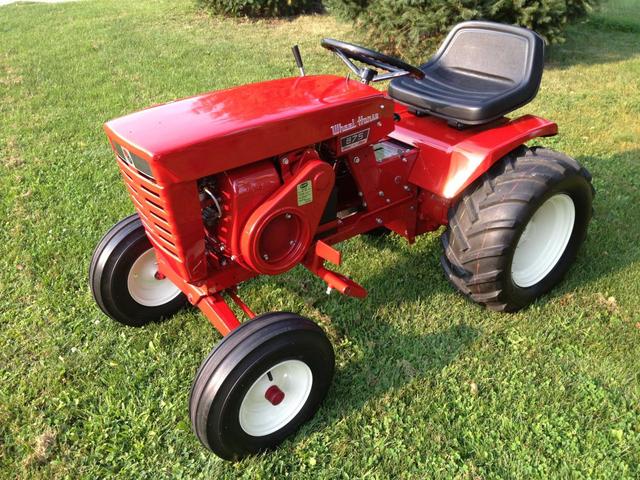

Martin 2,135 #12 Posted March 12, 2014 My son Kent loves driving around on his 875. We built this one together last year...... 2 Share this post Link to post Share on other sites
