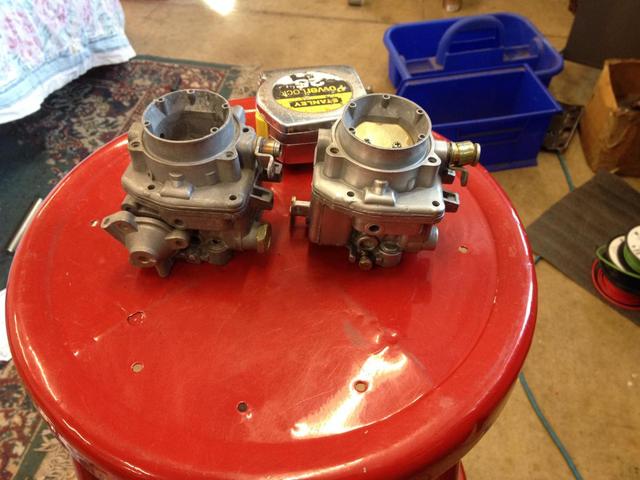

Martin 2,135 #5 Posted March 10, 2014 (edited) the emissions carbs didn't come about until spec g. spec a-f had a idle screw. if the carb (nikki) has an accelerator pump on the side it is a spec g carb and therefore a plug is there instead of adjusting screw. the accelerator pump is a dome shaped area on the side. heres two carbs, the one on the left is a spec g carb (accel pump) the one on the right is a-f ( no pump). you can see the lower idle hole has a plug on the left instead of a screw as on the right carb. im not sure when spec g started, i do know that my 1995 416H has a spec d engine and my 1995 416-8 has a spec g engine (california emissions). Edited March 10, 2014 by Martin Share this post Link to post Share on other sites

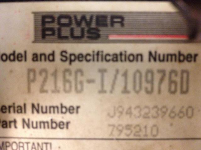

Martin 2,135 #8 Posted March 11, 2014 According to my manual it is a G. I think that's what the G is in P218G correct? What options or fixes might I do with? nope, the G as in P218G is not the spec but the model number. look at your tag on the engine...... its the last letter of the model and spec number.... model # P216G-I spec # 10976D D is the spec on this tag....... so it had a pre emissions carb from the factory. look at your tag and if it has the factory carb (or same replacement) you will know what you have. Share this post Link to post Share on other sites
JaysHorse 288 #9 Posted March 11, 2014 Says P218G-I / 10539B. Does that mean its a B? Share this post Link to post Share on other sites
JaysHorse 288 #10 Posted March 11, 2014 Really odd! The model # on the tractor is 31-18OE01 and the engine is P218G-I / 10539B. According to the tractor number it's an '88 but according to the engine model it's an '89. What gives? Do I have a hybrid/mutt? Lol Share this post Link to post Share on other sites
Martin 2,135 #11 Posted March 11, 2014 (edited) P218G-I / 10539B was used on 1988 and 1989 518H. (31-18OE-01 and 31-18OE-02) and yes it is a B so you should have a non emission carb if original. Edited March 11, 2014 by Martin Share this post Link to post Share on other sites
