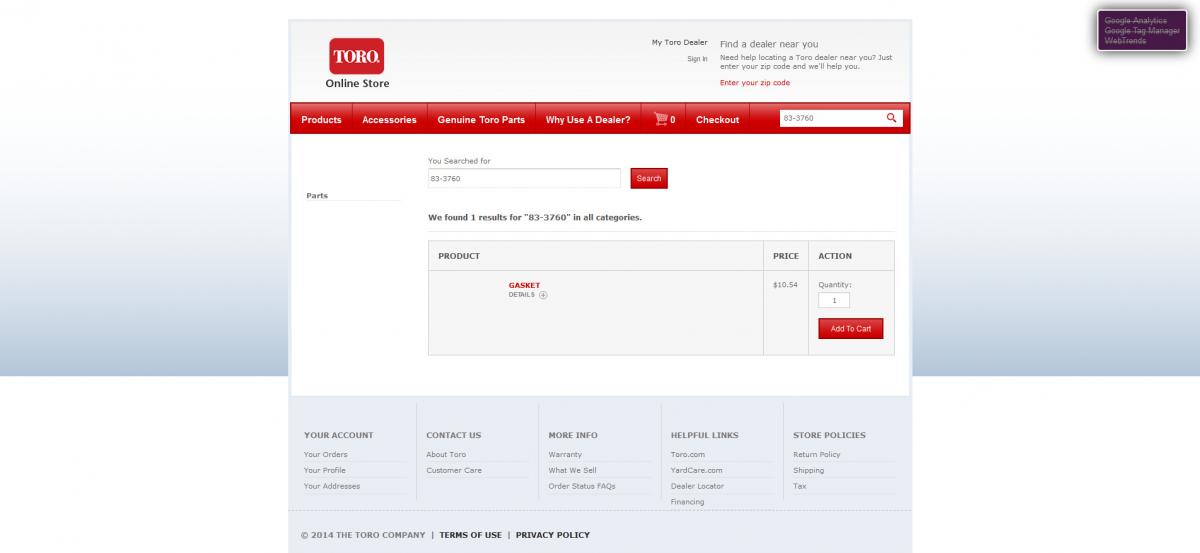

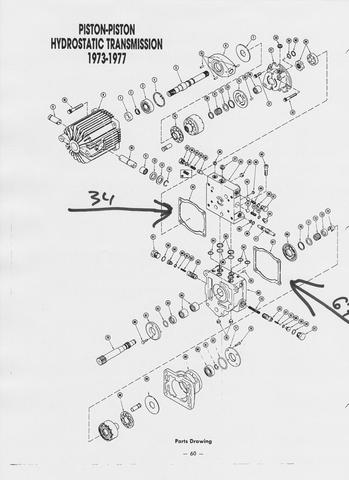

pfrederi 20,681 #4 Posted March 11, 2014 (edited) I am a bit confused. I looked again at parts tree and RCPW both showed the motor gasket as available 83-3760 about $11. Also at Toro for $10.54. The 83-3850 pump gasket is NLA. Are we talking about item 34 and item 67 ??? Edited March 11, 2014 by pfrederi Share this post Link to post Share on other sites

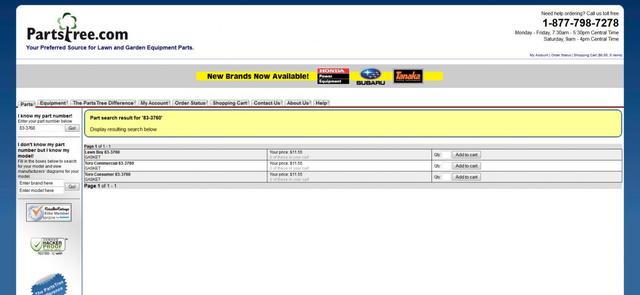

Whmaverick 54 #5 Posted March 12, 2014 Not sure what RCPW is, so I looked again at parts tree and I can only get to the parts frame that shows the gasket that goes between the hydro unit and the trans axle. Don't need that one. So as not to confuse anyone, I'm asking for help. Cause when I click on 74' C-160 auto the list of components shows the Section for hydrostatic transmission, so I click on that and it only shows a limited list of parts including the gasket that goes between the hydro unit and the trans axle. Again dont need that one. I don't see anyway to get to a parts list for the hydro unit showing the exploded view that you show, with the two gaskets for the pump housing and the motor housing. I don't know why your dealer can get them but mine can't. But if your more Internet savey and or your local dealer is better than mine then maybe help me get the gaskets I need. And if you can't get them all then I guess I'm back to where I was before all this typing to get you unconfused. I still need to know what material, thickness and sealant if any that works for others that have successfully refurbed their hydro unit? Humbly asking for help, not to confuse anyone with technical what nots. So maybe some one can help me get two of the three gasket for the refurb, but I am still in need of the info I've been asking for so I can make the third gasket that is NLA. Whew, now I'm concussed, LOL Share this post Link to post Share on other sites
pfrederi 20,681 #6 Posted March 12, 2014 Sorry Replacement parts Commercial Warehouse www.rcpw.com The motor gasket is still available just type the part number 83-3760 into parts tree or Toro or RPCW. The pump gasket is thicker than the motor gasket i measured it a .0185. i am not an expert on types of gasket material but if you order a motor gasket you can see the type...just remember you need thicker for the pump (.0185) I use Permatex High Tack spray. I have put together 3 of these things...never had a leak at these gaskets...shaft seals yes manifold yes but not here. Share this post Link to post Share on other sites
