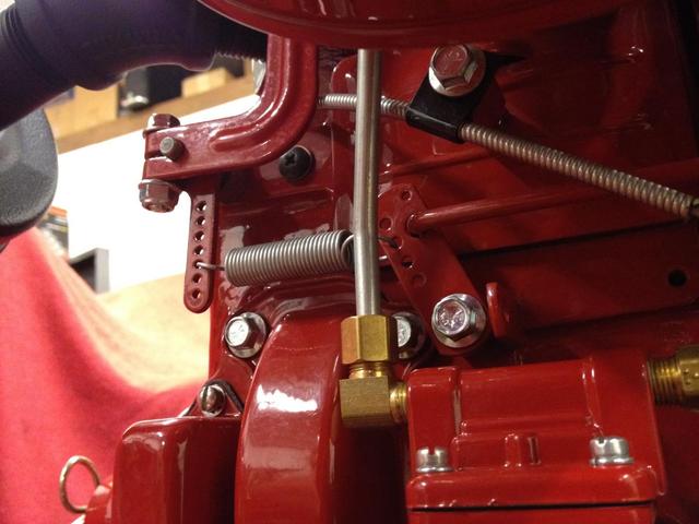

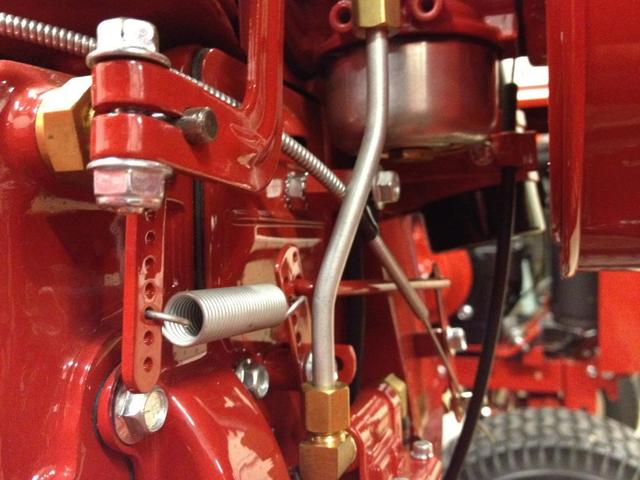

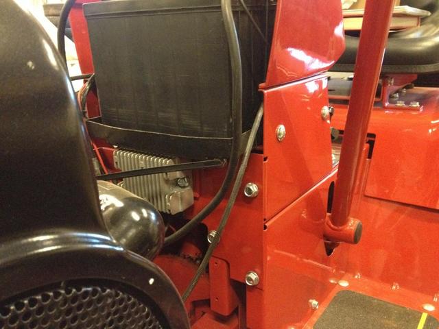

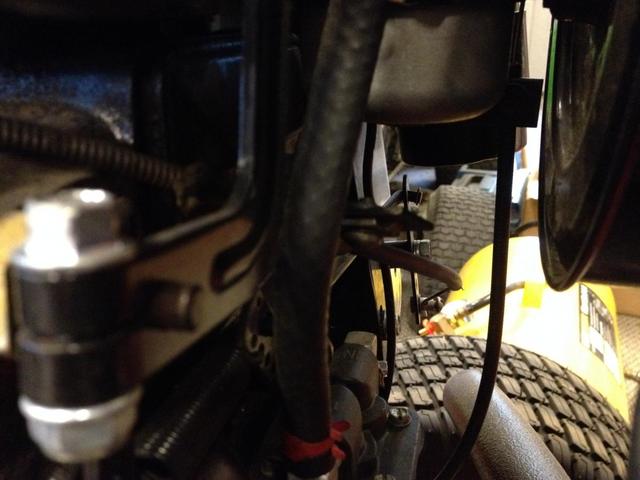

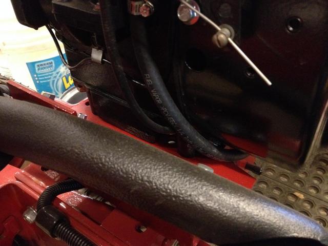

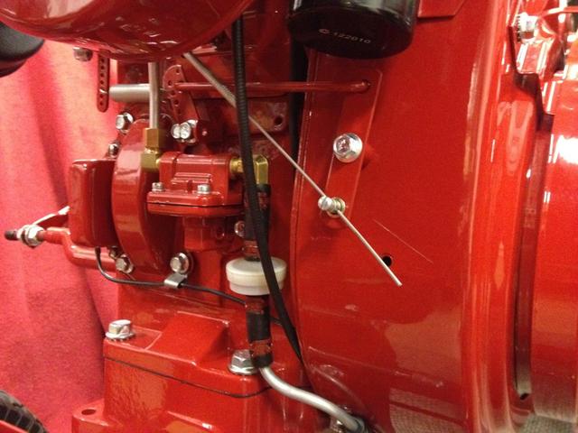

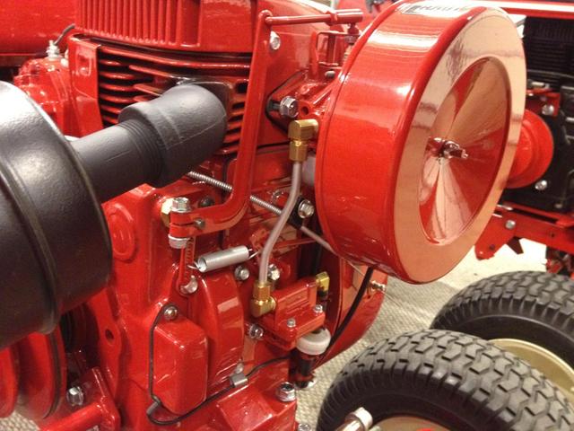

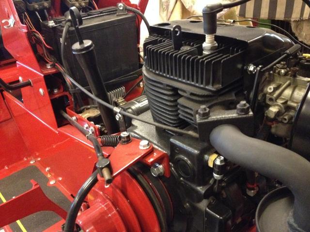

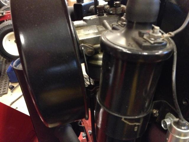

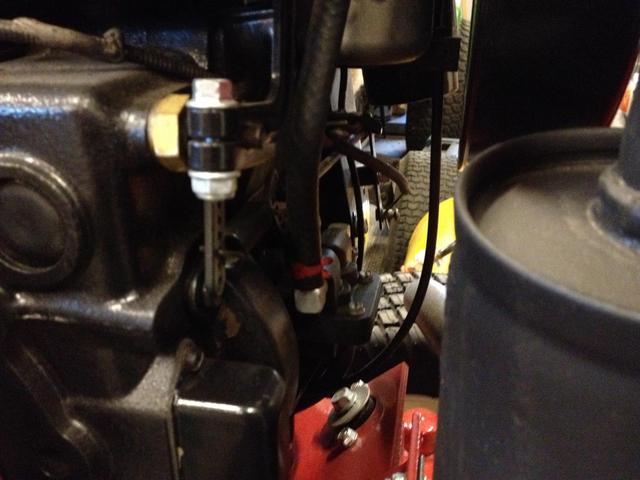

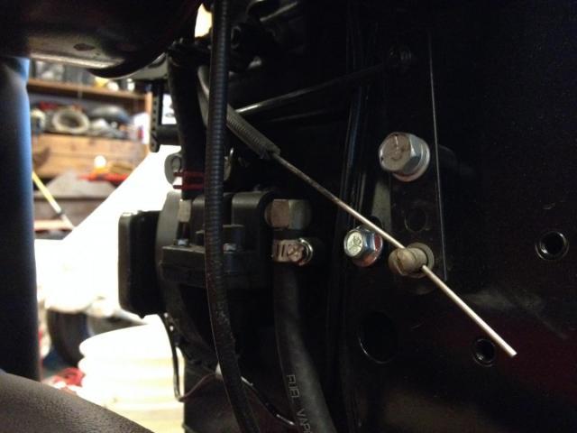

Martin 2,134 #2 Posted March 6, 2014 heres some pics of my c125 throttle and choke cable routing. pics are a little dark, but you should be able to make out whats going on. click the pics to make them larger.... these models are very basic with the routing. as long as you have the brackets/clamps to support the cable, 2 on the throttle and one on the choke, its easy. the first pic shows the back bracket for the throttle, the front clamp/standoff comes off the breather bolt.. the choke uses the standard bracket at the carb. bracket at the breather, don't have a better pic than this..... Share this post Link to post Share on other sites
woodchuckfarmer 333 #3 Posted March 7, 2014 Those have to be Martins great c-125 rebuild pictures. Share this post Link to post Share on other sites
Ol' Red 0 #5 Posted March 10, 2014 Ok I have no brackets! I also don't have that whole assembly (mounted on blower) that you show on that third pic! Anybody know where I can find the parts I need to make this thing right again? Share this post Link to post Share on other sites

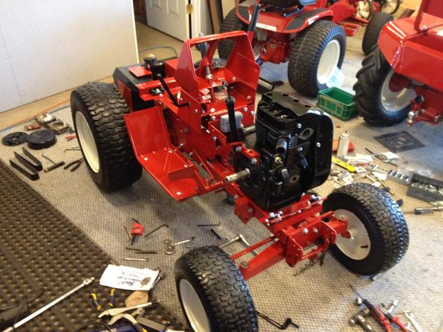

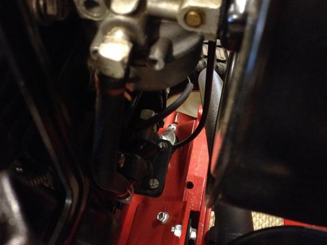

Martin 2,134 #6 Posted March 10, 2014 parts will be very similar to this setup on one of my earlier kohlers. at least you can see how the parts are. the black and dark pics aren't real informative. Share this post Link to post Share on other sites
Ol' Red 0 #7 Posted March 10, 2014 Man that makes it clearer to see! But where can I obtain these parts like mounted on the blower? Share this post Link to post Share on other sites
