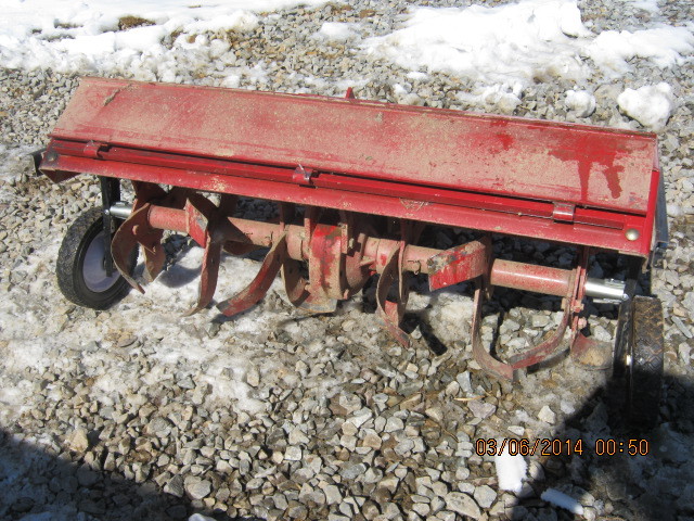

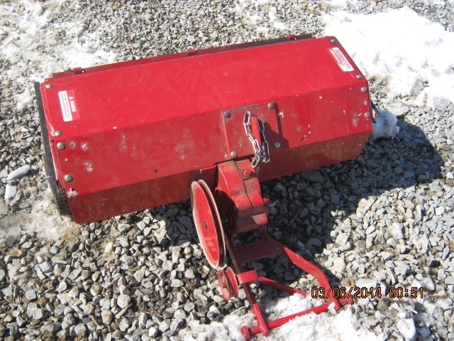

swarfeater 49 #1 Posted March 6, 2014 (edited) picked up this from cl yesterday for $300. great condition, i suppose, came with everything except rear bracket. saw the post from fungus and saw the pics for the bracket along with dims, so instead af asking if anyone has one to sell, i'll go ahead and put one together. thanks for the pics and dims. BTW the wheels the po added to make it easy to wheel around the garage, they pop off with a couple of loose bolts. Edited March 6, 2014 by swarfeater Share this post Link to post Share on other sites

swarfeater 49 #7 Posted March 10, 2014 The wheel brackets are just some kind of small channel steel metal screwed together with some rivits here and there. the tubes look like electrical conduit just big enough to slide inside of the tine tubes, these keep the assembly from moving back and forth. not really to much there, pretty simple, but they work. each one bolted to the tiller sides with 3/8 bolts. Share this post Link to post Share on other sites

Kelly 1,038 #10 Posted March 11, 2014 also when building the axle bracket be sure to build it good tillers are ruff on them, and be sure to drill the latches for locking pins, my first time tilling with out the pins the tiller would drop out of the mount, one time tore up the belt, that was a $70 opps Share this post Link to post Share on other sites
