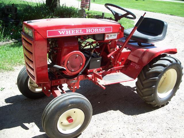

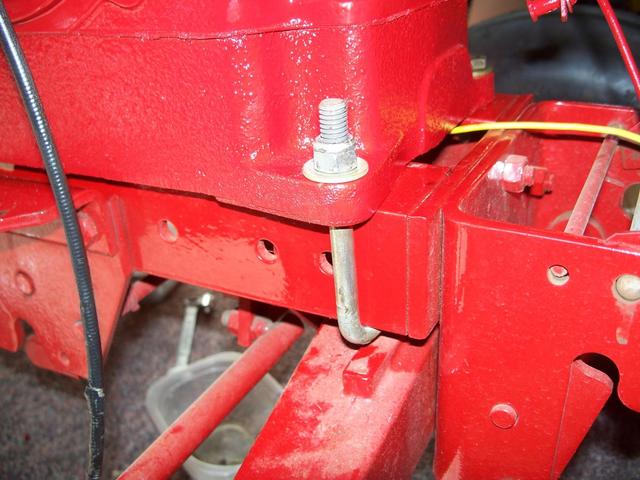

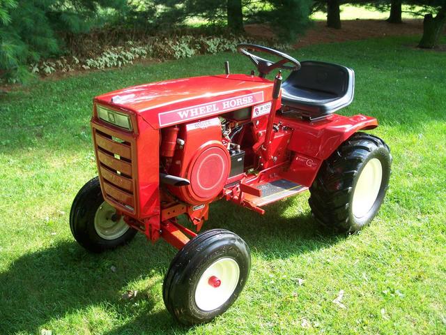

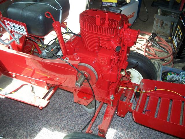

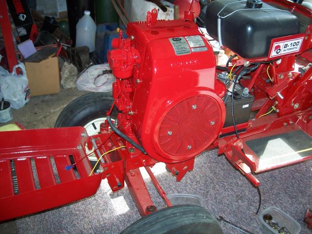

Kelly 1,038 #10 Posted March 5, 2014 Oil pans can be swapped, I'm sure I have one I could sell you. here are a few pics of a swap much like you are doing I did last spring in my sons B-100 when I built it I put a 8hp in it because I had it and it ran great, well now about 5 years later he wanted the bigger engine in it so we put a 12hp in, because it is a mid frame tractor much like your 8hp machine, you have to use a J bolt on the front right corner, and yes it is factory on this style frame, others the frame is a little longer and you have room to install the bolt from the bottom, and because your oil pan does not have the holes in the bottom you could J bolt both holes on the right side, here is a few pics hope they help. Another thing you will have to address is the wiring will need to be longer, but no big deal, and the choke and throttle cables will need to be changed for ones to fit the bigger engine, and have you checked the crank diam. ?? if it's 1" your good the 8hp pulleys and PTO sleeve will fit, if 1 1/8" you will need different ones. With the 8hp and the riser plate for it the big 12 bolted it J bolt I was talking about Almost done Happy young man, now to wash it All washed this took about 4 days but that is including painting the engine, actual time to do the swap was about 4 hours with rewiring and the other stuff needed in the swap. Share this post Link to post Share on other sites
