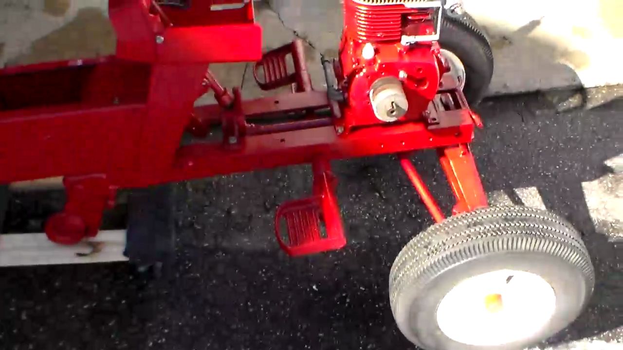

Retired Wrencher 7,036 #4 Posted March 1, 2014 (edited) Mr 856 does this help??? there is a bushing that goes on the shaft that fits inside of console. Gary B..... CLICK ON PICK TO RIN... Edited March 1, 2014 by T1257 1 Share this post Link to post Share on other sites
Mr. 856 170 #5 Posted March 1, 2014 Yes it does!!! Thanks for taking the time and great video and tractor!! Did you get to finish it? Share this post Link to post Share on other sites
Retired Wrencher 7,036 #6 Posted March 1, 2014 Yes it does!!! Thanks for taking the time and great video and tractor!! Did you get to finish it? Thanks Mr 856 no waiting for warmer weather and a new carb and a back ordered Governor linkage. good luck with your project. Gary B..... Are u in the state of Connecticut ??? Share this post Link to post Share on other sites
Mr. 856 170 #7 Posted March 2, 2014 Yes I am and I see you are from springfield........so that puts you and I approx. 10 minutes from each other. I live in suffield. What do you need for governor linkage? Is that a Tecumseh on there? Share this post Link to post Share on other sites
Retired Wrencher 7,036 #8 Posted March 2, 2014 (edited) Yes I am and I see you are from springfield........so that puts you and I approx. 10 minutes from each other. I live in suffield. What do you need for governor linkage? Is that a Tecumseh on there? IT is a HH60 and the linkage is on the way. I hope to see @ some shows this year. There are a lot of them close buy 1hr or less. If u need help with this let me know I can get the list. Take Care Gary B................. oohh this one came out of Suffield I hated to sell it ran so smooth! But needed the room. CLICK ON PICK TO MAKE LARGER. Edited March 2, 2014 by T1257 Share this post Link to post Share on other sites
