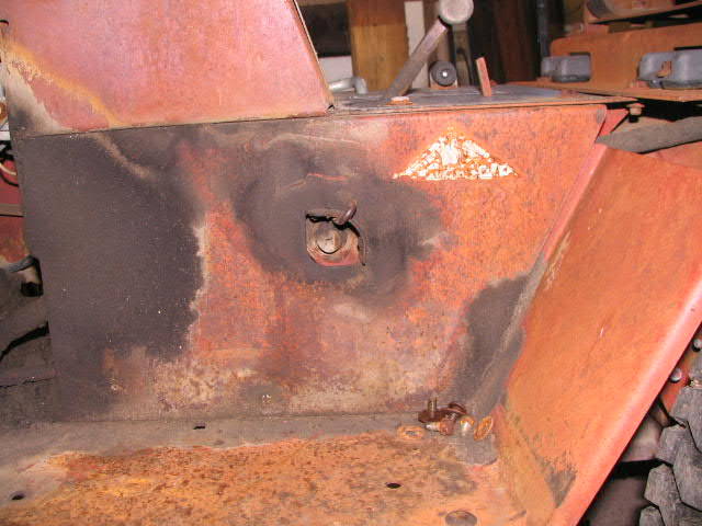

pacer 3,181 #1 Posted February 28, 2014 What is this ... valve? on the left side of this C-175 auto? It seems like its off the hyd - my first thought was it was the tow valve but I cant find ANY reference to one on this model. Its right on the outside near the lines going to the lift cylinder - does it bypass the lift cylinder? In fact I cant find any reference of any thing in that area! Anybody?? Share this post Link to post Share on other sites
squonk 48,322 #2 Posted February 28, 2014 (edited) That is hooked to the lift linkage. The piece sticking out was the height indicator. The metal piece with the numbers indicating the lift hight is gone or almost gone that curved edge had the height decal on it Edited February 28, 2014 by squonk Share this post Link to post Share on other sites
pacer 3,181 #3 Posted February 28, 2014 Great Mike! thats actually pretty neat! I didnt even mention that its not running - the engine is toast (got burned on that one :angry-nono: ) and Im trying to determine if the Eaton is useable without power... Share this post Link to post Share on other sites
