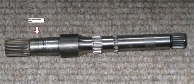

pfrederi 21,301 #8 Posted February 28, 2014 The speedi sleeve is a thin metal band that cover up groves in the surface seal runs on. For this application it is #99076 from SKF and my dealer wants $26 for this small band. The seal CR 7475 is $11. I will try to get a picture of teh shaft later today. You will have to remove the pump to change the shaft. While you have it out as others said you need to get the manual from here and tear the pump down. The shafts do not usually break but in your case having some idiot drill a hole in it may have been the cause.... Share this post Link to post Share on other sites
pfrederi 21,301 #9 Posted March 1, 2014 (edited) This is the shaft I have. It will need a speedie sleeve where I indicated or the seal will not work for long. The splines are not perfect and you nay have to dress them a bit with some emory cloth to let the speedi sleeve slip by them. Over time the splines get a bit deformed and come to a point instead of a flat edge. Here is listing for seal and sleeve http://www.skfextranet.com/Catalogs/457010/sealdetail.asp?s=7475 PM me your address you can have the shaft if you will use it. Do you have the rubber connector that attaches the shaft to the engine?? Edited March 1, 2014 by pfrederi Share this post Link to post Share on other sites
