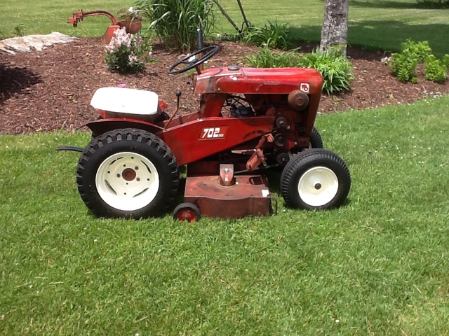

stevebo-(Moderator) 8,648 #6 Posted February 27, 2014 This is Navajho White (mixed) at ace to match rusto navajho white. 2 Share this post Link to post Share on other sites
AMC RULES 37,259 #7 Posted February 27, 2014 Wheels do look great Steve... didn't you say you brushed that new paint on 'em? Share this post Link to post Share on other sites
stevebo-(Moderator) 8,648 #8 Posted February 27, 2014 Yup... I typically use a good brush and it lays down nice. The slight brush marks are usually the look I go for on non restored tractors. If I were doing a complete restore then I would spray them. Share this post Link to post Share on other sites
