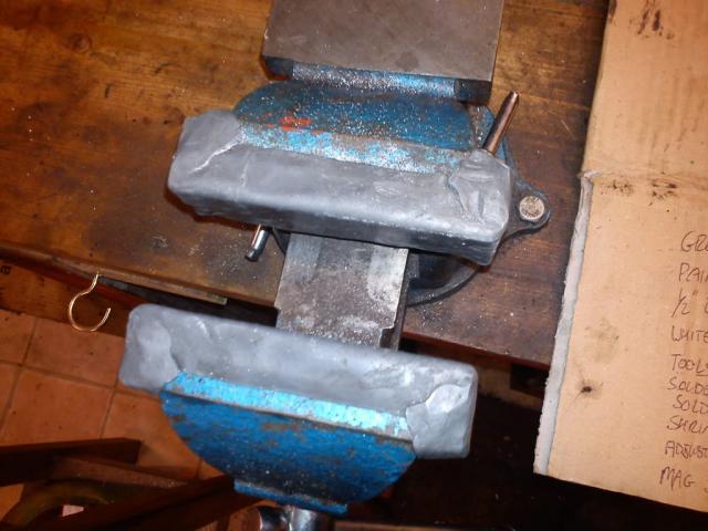

neil 2,415 #7 Posted February 22, 2014 protect your work from scatching by making these vice jaw protectors , normally made from Aluminum but these are made from sheet Lead which is much softer than Aluminum & are much easier to make & are much softer than Ali 4 Share this post Link to post Share on other sites
Digger 66 3,525 #8 Posted February 22, 2014 protect your work from scatching by making these vice jaw protectors , normally made from Aluminum but these are made from sheet Lead which is much softer than Aluminum & are much easier to make & are much softer than Ali Great tip ^ I've got aluminum "soft-jaws" but I've used pieces of leather too . Share this post Link to post Share on other sites
