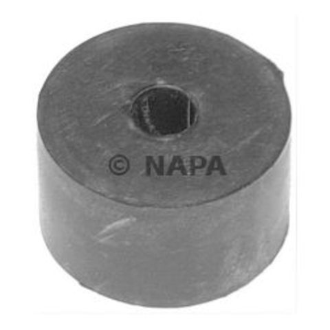

squonk 48,319 #6 Posted February 22, 2014 Here's what a 56 Chevy 265 mount looks like. From a Napa site. no dememsions given 2 sizes small 602-1044 and large 602-1045. about 5 bucks 1 Share this post Link to post Share on other sites
312Hydro 474 #7 Posted February 22, 2014 (edited) Google - motor mounts for a 1955-1957 Chevy Choose Google Shopping Lots of options once you know the size. Summit has both sizes for .97 made by Anchor. Edited February 22, 2014 by 312Hydro Share this post Link to post Share on other sites

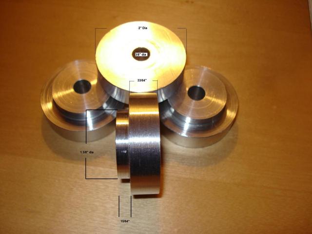

Anglo Traction 761 #8 Posted February 22, 2014 Not sure if this will help you. They are not B Miller's and they're not Steel. They are turned from Aluminium Billet. I supplied Ian (Stigian) with the material so he could make some for his 312-8 (I think). There was sufficient for 2 sets, so he turned them up. These will go to another WH Owner friend when I get to visit him. Hopefully, if you click on the image, it will enlarge so you can see the dimensions easier. If not, I'll post them up again. I've been pedantic with the Dims. Motor plate thickness is 1/4" I believe, so I've stated 15/64" to ensure it is clamped by the Bolt and Large Washer..... Share this post Link to post Share on other sites
Wheel-N-It 2,978 #9 Posted February 23, 2014 Now I'm wondering if the 55-57 Chevy motor mounts will work if they are modified to look like the ones Richard has shown us? I've paid $80 or $100 (can't remember the going rate at that time) for factory ISO mounts for my Cub Cadet 1650. That IMO is a bit steep, and the engine still shakes like all K341's do in a 1975 Cub Cadet. It sure would be nice to buy some $5 motor mounts like the ones Mike has posted a pic of. Share this post Link to post Share on other sites
