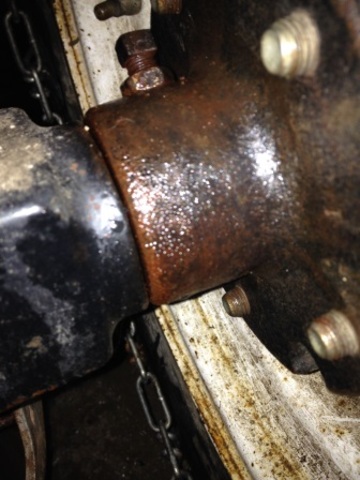

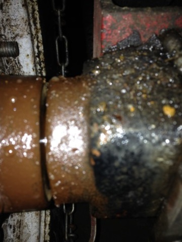

rj24 38 #7 Posted February 21, 2014 (edited) how a bout this is this ok whis is the bad side this is the good side I thank that is how it go's Edited February 21, 2014 by rj24 Share this post Link to post Share on other sites

stevasaurus 23,814 #9 Posted February 27, 2014 Are you talking the hub itself...or the axle that is moving??? The hub should not move in and out on the axle. The axle could move in and out about 1/8" and is still OK...just play between the axle gear and the "C" clip. Share this post Link to post Share on other sites
rj24 38 #10 Posted February 28, 2014 Are you talking the hub itself...or the axle that is moving??? The hub should not move in and out on the axle. The axle could move in and out about 1/8" and is still OK...just play between the axle gear and the "C" clip. i thank its the axle you can see it in the pic but when it movers on the left side it leack a lot of oil Share this post Link to post Share on other sites
stevasaurus 23,814 #11 Posted February 28, 2014 Jack up the rear end of the tractor...remove the tires and hubs...both sides. You should have little to no axle movement up and down...or side to side. This would tell you if you have a bad axle bearing. In and out movement of the axle should be about 1/8"...the slack between the axle gear and the "C" clip inside the trans. If the "C" clip is gone, you could possibly pull out the axle from the trans. Do not pull it out...you will have to open up the transmission to put it back in...but you would have to open the transmission to fix the "C" clip anyway. You can pry the seals out with an awl or ice pick and replace them if all else is OK. Wheel Horse #6449 for the seals from TORO. Share this post Link to post Share on other sites
