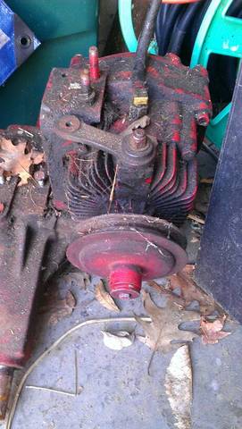

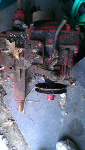

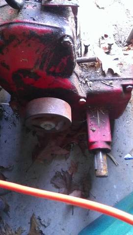

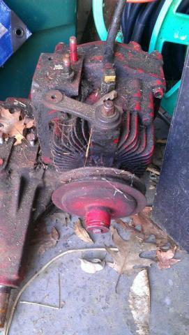

64s 83 #1 Posted February 17, 2014 All of my runners are gear driven and I don't know anything about hydros. I picked this up a number of years ago and now I don't remember what it came off of or what kind it is. Can anyone tell me based on the pictures? Thanks. Sent from my ADR6425LVW using Tapatalk Share this post Link to post Share on other sites
daveoman1966 3,633 #2 Posted February 17, 2014 Given the cut-off hose coming out of the top of the hyd pump, this looks like an Eaton 700 series hydro trans. Accordingly, it would probably be from a 300 series tractor such as a 312 or 314 or the like. It isn't from a 500 and probably not the 400 series either. Share this post Link to post Share on other sites
Hodge71 663 #3 Posted February 18, 2014 No filter….. I would definitely say its an Eaton 700 Share this post Link to post Share on other sites
rustyoldjunk 127 #4 Posted February 18, 2014 The 516 and 518 also used the 700. Share this post Link to post Share on other sites
