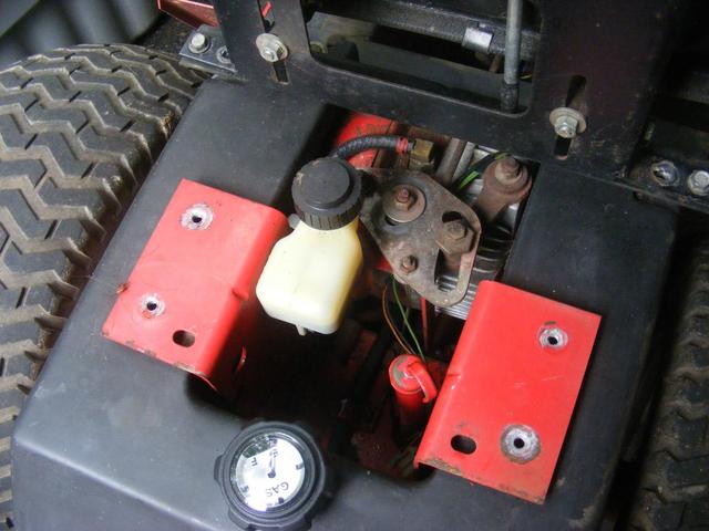

sorekiwi 761 #16 Posted February 16, 2014 I don't have a good pic of the reservoir, you can see a bit of it here: Share this post Link to post Share on other sites
PMaine 31 #17 Posted February 16, 2014 Theres mine! Share this post Link to post Share on other sites
squonk 47,476 #18 Posted February 16, 2014 Looks like an invisible tank! Was it there when you got it? Oil is expanding from getting hot and blowing out that elbow. The tank would normally collect it. Share this post Link to post Share on other sites

shallowwatersailor 3,221 #22 Posted February 16, 2014 Here is a picture of the top of the Eaton 700 without the fender pan. The reservoir is not under pressure and is is just an expansion tank. It sounds like it may be just leaking from the top fitting where the reservoir goes. I would only run 30W oil in it, although my one dealer told me to use synthetic 15W-50. Share this post Link to post Share on other sites
PMaine 31 #23 Posted February 16, 2014 Thanks. I found one of these on ebay, says it fits a 518h and 520h, I assume it will work for me? Share this post Link to post Share on other sites
shallowwatersailor 3,221 #24 Posted February 16, 2014 (edited) Thanks. I found one of these on ebay, says it fits a 518h and 520h, I assume it will work for me? That looks right if it is the one from A and J. The 520-H does not use a reservoir. Edited February 16, 2014 by shallowwatersailor Share this post Link to post Share on other sites
