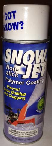

Gurutoro 1 #7 Posted February 15, 2014 I bought 3 cans of this online at $bay and haven't had a clog yet. 1 Share this post Link to post Share on other sites

Lane Ranger 12,094 #9 Posted February 15, 2014 I use sno jet and I spray it on the front of snowplows also! Works well for me. Share this post Link to post Share on other sites

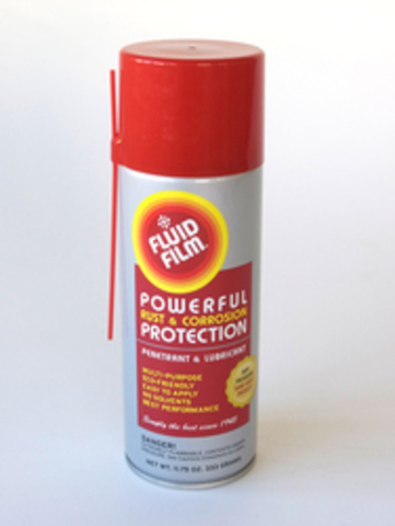

lae51967 18 #10 Posted February 15, 2014 I just came across a product called Fluid Film (www.fluidfilm.com). I was able to buy it at my local O'reilly parts store. I got it primarily to use on the blower chain and sprockets. I sprayed it on my blade and was able to use it for the first time this morning, snow rolled a lot better and didn't stick. Think I'll try coating the blower chute but not sure if I'll get another chance to use it this year or not. Share this post Link to post Share on other sites
RMCIII 840 #11 Posted March 6, 2014 I bought 3 cans of this online at $bay and haven't had a clog yet. Best stuff you can buy, and it does out perform anything on the market.... I even tried the Pam thing... < Not at all happy with those results... Keep a supply of Snow Jet in the winter and during the summer, sand and repaint as needed. Share this post Link to post Share on other sites
