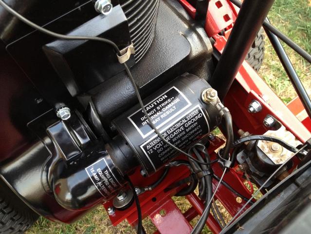

W/H JUNKY 43 #1 Posted February 14, 2014 Does anyone have a wire schematic for this tractor? Iam restoring this one also but can not get the starter to turn over. The sol. Clicks and sends power to the stater but it dont even make a sound. I hate to tap on it now that it is all repainted. Does anyone have any suggestion. Thanks in advance. Chris Share this post Link to post Share on other sites

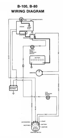

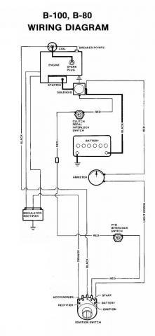

rmaynard 17,574 #2 Posted February 14, 2014 (edited) It's in the manuals section. The wiring diagram is in the owners manual. Edit: It's in my manual, but it may not be in the ones in the manual section. I will check. Here's a copy of it. Edited February 14, 2014 by rmaynard Share this post Link to post Share on other sites

W/H JUNKY 43 #4 Posted February 16, 2014 Thanks everybody found that the wire from the solenoid to the starter had a bad crimp at the wire connector. 1 Share this post Link to post Share on other sites
