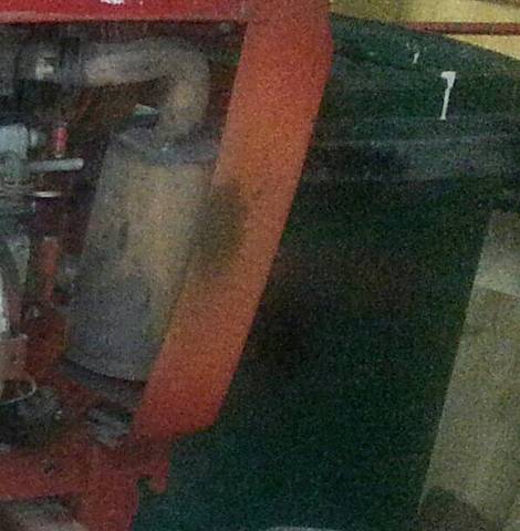

redrooster 83 #1 Posted February 10, 2014 Has anybody ever considered addressing the problem of the muffler getting the hood to hot causing the paint to discolor? I'm considering heat wrap for the muffler or applied to the hood. Share this post Link to post Share on other sites

rmaynard 17,508 #6 Posted February 10, 2014 That muffler should have a tab at the bottom that attaches to the front of the engine cradle. Make sure that it is attached. That will set the correct position of the muffler. When they came from the factory, they didn't burn the paint or Wheel Horse would have had a lot of claims I suppose. So I would look for a couple of things that could be making the muffler run too hot. 1. A broken baffle causing a partial blockage; 2. Carburetor set too lean; 3. A leaky exhaust valve. Share this post Link to post Share on other sites
redrooster 83 #7 Posted February 10, 2014 The short block doesn't have a lot of hours on it. The carburetor is being rebuilt. How would I know if the muffler isn't to hot? Hate to take a chance with expensive paint!! Share this post Link to post Share on other sites

Kelly 1,038 #9 Posted February 10, 2014 If the engine is tuned correct and the muffler is in the right place it will take years to discolor the paint, I have a couple repaints with stock mufflers and never had a issue 1 Share this post Link to post Share on other sites
redrooster 83 #10 Posted February 10, 2014 Thanks Kelly!! Full speed ahead with the stock set-up! :-) Share this post Link to post Share on other sites
