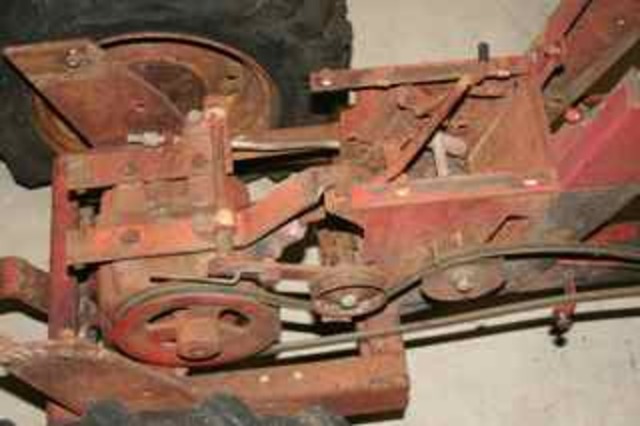

Rydn49 4 #1 Posted February 10, 2014 I am brand new to this forum but I am in need of some help. I have a 1974 A90 Special that I think has an issue with the transmission. I have the tractor broken down to just the frame and trans. The issue is when i spin one side of the axel the other side spins in the same direction, like its locked. I can spin the axel with my hand and when I spin the fly wheel the axel seems to spin properly. I am able to go into all three gears and reverse and neutural seems to work ok. Now I say all of this but I have never driven the tractor and this is all done with out the tractor running. The other thing that I noticed was on each of the back wheels the axel stuck out about an inch on either side of the rim. I thought the axel should be flush with the out side of the rim. Any help would be greatly appriciated. I will attach a picture or two, but please feel free to let me know what other pictures would be of help in solving my issue. I am worried about taking the transmission apart due to lack of parts and knowledge. But I also want to fix any issues. Thanks Chris Share this post Link to post Share on other sites

Rydn49 4 #10 Posted February 10, 2014 Thanks ol550 for the insite. I have not trained it yet. Tonight it will be coming off of the frame and then drained. I will give the diesel fuel a try, how long should I let it sit with the fuel inside? If this does not work I will spit it then go from there. I do think that both axle seals are leaking and need to be replaced. Great observation, I went back to look at my picture and i am assuming you noticed the oil on the inside of the rim. Any more imput would be greatly appriciated. Frank thanks for the info, not sure I want to scrap it just yet. But you never know, I do want to be able to turn the thing and not just go in a straight line. Thanks Chris Share this post Link to post Share on other sites

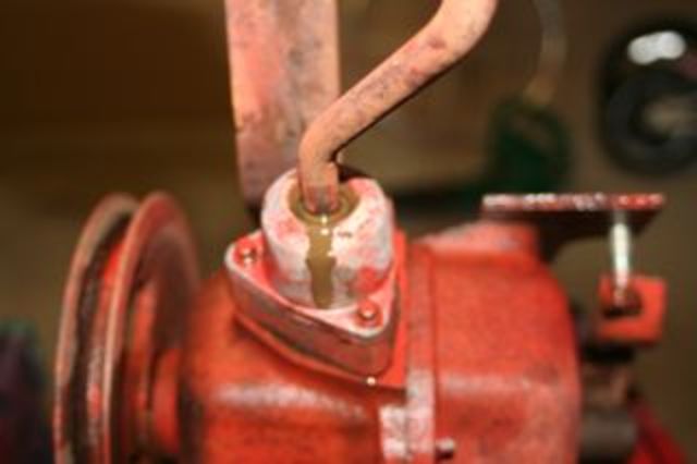

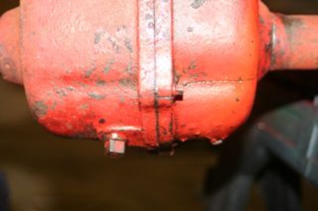

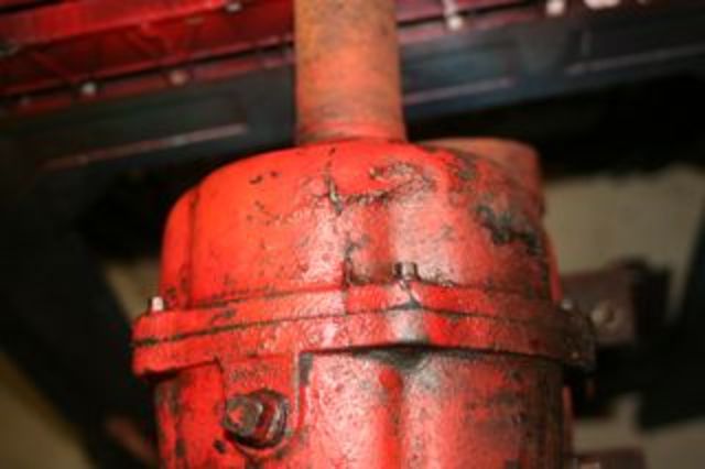

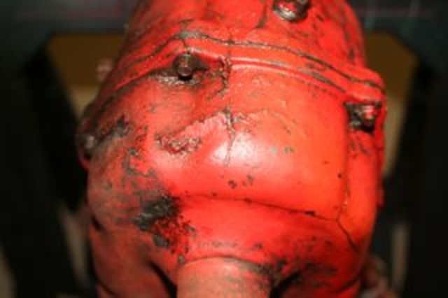

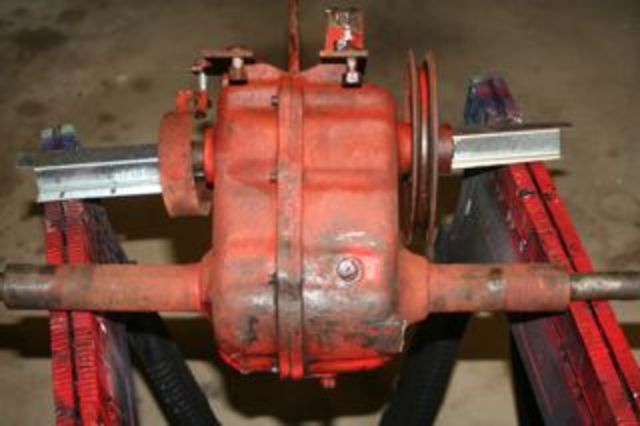

Rydn49 4 #18 Posted February 11, 2014 Steve thanks for the help. I found the Elec Trak this morning. Funny we both found this today. I took the tranny out tonight and will next drain and fill with diesel. Please see the pics I took. It appears that the case has been welded were it may have had a crack. In one of the pics you can see the weld and a surface crack that does not seem to be to deep. I also noticed when the tranny was upside down oil was leaking out of the shifter, is that normal? Thanks all. Share this post Link to post Share on other sites
ol550 879 #19 Posted February 11, 2014 Your case does look rough, but does it leak around any of the places where there look to be cracks? Do a little cleaning at the rough places to determine if they are cracks or just a crappy mold job. the leak at the shifter is fine any other leaks, not so good. Keep us updated. 1 Share this post Link to post Share on other sites
Rydn49 4 #20 Posted February 11, 2014 ol550 Does not seem to be leaking from the cracks but still need to do alot of cleaning to be positive. What do you think about the color of the oil coming out, is that usual for a case that has not been drained for a long time? Thanks for taking a look. Chris Share this post Link to post Share on other sites
stevasaurus 23,882 #21 Posted February 11, 2014 Nope...that oil has some water in it. Share this post Link to post Share on other sites
Rydn49 4 #22 Posted February 11, 2014 Thanks Steve. I thought it looked a little "watered down". Will be draining the trans tonight and hopefully filling with diesel tomorrow. I tried your suggest with holding one side will turning the other with no different result. Hoping that the diesel will break down the rust. Pictures to follow. Thanks Chris 1 Share this post Link to post Share on other sites
Rydn49 4 #23 Posted February 13, 2014 Bad news. The trans is leaking at the crack in the pics above. Tried to fill the trans with diesel and the crack started leaking. Looks like it will need to be welded up. Any suggestions on welding the trans crack. Inside our out? Also the trans is leaking at both seals at either shaft. This project is getting tougher by the day. Steve I took a look at your 2012 sow pics. I bet that show is a blast. Looks like u had a great trip. Thanks for your help. Chris 1 Share this post Link to post Share on other sites
