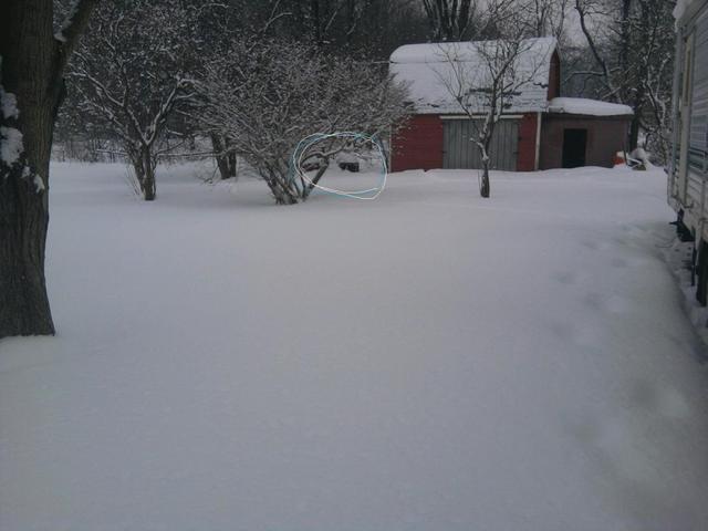

WH nut 553 #14 Posted February 9, 2014 Thanks Dave. Kelly may have found one. Will find out this afternoon. Here is my possible donor if I can get to it enough to pull the part. left side of shed circled Share this post Link to post Share on other sites
squonk 47,363 #15 Posted February 9, 2014 Looks like you need a team of sled dogs! Better call Mikes RJ! Share this post Link to post Share on other sites
