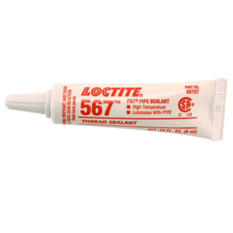

rmaynard 17,642 #8 Posted February 9, 2014 I had a mechanical one that pumped okay, but continued to seep at the diaphragm. I took the two halves apart, sanded them on a flat surface, then carefully added a small amount of Teflon pipe sealant to both surfaces, snugged the screws and have not had a leak since. 1 Share this post Link to post Share on other sites
zanepetty 117 #9 Posted February 9, 2014 (edited) Can I get the tape at Napa, Bob? I have yamabond #4 and some fuel safe thread sealer as well. Edited February 9, 2014 by zanepetty Share this post Link to post Share on other sites
rmaynard 17,642 #10 Posted February 9, 2014 It's not tape, it is a paste. Share this post Link to post Share on other sites
zanepetty 117 #11 Posted February 9, 2014 (edited) Oh OK. I have yamabond #4 and fuel safe pipe thread sealer. But if you had good luck with that I'll use that. Where did you get it? Also would it be bad to use that around the o ring in my sediment bowl? Edited February 9, 2014 by zanepetty Share this post Link to post Share on other sites
chazm 413 #12 Posted February 9, 2014 Oh OK. I have yamabond #4 and fuel safe pipe thread sealer. But if you had good luck with that I'll use that. Where did you get it? Also would it be bad to use that around the o ring in my sediment bowl? Don't use pipe dope on the bowl o-ring... best to smear a LITTLE oil on the o-ring to help seal , I believe those o-rings are a square cut type o-ring ... if it is be sure it isn 't twisted Share this post Link to post Share on other sites
