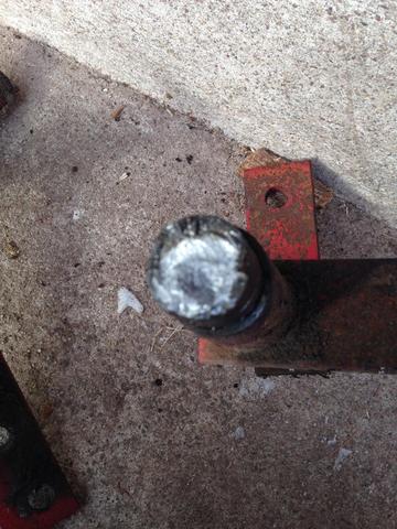

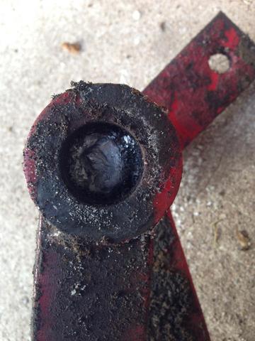

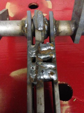

Hodge71 691 #4 Posted February 8, 2014 Well I wish I could say it was good news….as you can see my 1 piece shaft is 2 pieces now. It frustrating to do all this work and finally get to use it and this happens. No clue how this thing could break especially as I use a chain on my plow instead of a solid link. I guess maybe someone before me possibly used a mid grader or possibly a solid link ….I guess it will be pondering how to fix this situation because it was a torsional break and therefore nothing really lines up the way it was intended due to the way it twisted when it broke….I guess the ole girl will be down for the count for awhile….. Share this post Link to post Share on other sites
brandonozz 168 #5 Posted February 9, 2014 (edited) Wow Jeff sorry for your luck. That wasn't what I was expecting but on second thought I guess I shouldn't be too surprised. I have two D's (a runner and a parts tractor) and one of the bellcranks (on one of the tractors) is not factory so I guess the PO had broke it at some point. Get these tractors weighted down and moving and then hang something like a grader blade on a rock or tree stump and something is going to give. Good luck getting it going. Edited February 9, 2014 by brandonozz Share this post Link to post Share on other sites

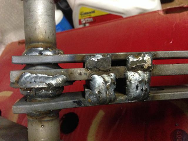

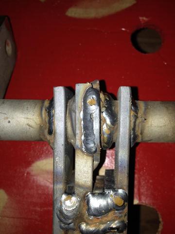

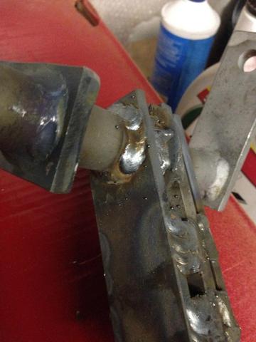

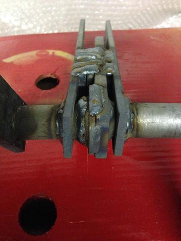

Hodge71 691 #9 Posted February 12, 2014 Well She's all back together and not a moment too soon… Straightened and welded everything up and got her back together tonight at 6 PM….Had to make a new lift chain as the one that was on there was 5 links too short once I had welded everything square and in their proper position. Much better now and if it breaks after this I will be beside myself in disbelief….. Its amazing how misleading pics can be…Those welds looked a whole lot better in real life….. oh well…. 1 Share this post Link to post Share on other sites
brandonozz 168 #10 Posted February 13, 2014 Glad you got it going Jeff. It doesn't matter what them welds look like as long as they hold (especially since no one will see them under the tractor). Share this post Link to post Share on other sites
wheeledhorseman 579 #11 Posted February 13, 2014 Looks as though that should hold Jeff. I remember from doing my 3-point that getting a textbook weld on the shaft down in between the flat bars is pretty much impossible. Andy Share this post Link to post Share on other sites
