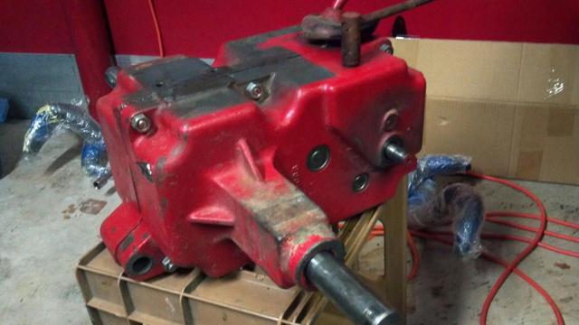

monsstr 35 #1 Posted February 6, 2014 Good afternoon gentlemen, This is my first post with hopefully many more posts to come later as I become more knowledgable. A few years ago I bought my Raider 12. It was in excellent condition and I use it to plow snow, dirt and haul my trailer around the yard. On Monday as I was plowing the snow we received, all of a sudden the tractor stopped moving, no noise or anything, just stopped going but yet the drive pulley was still spinning. Today I removed the transmission from my tractor and I am able to turn the axle by hand and it will turn the drive pulley and then at some point it will make a noise like gear teeth running over the top of other gear teeth and the drive pulley wont spin as it should. I am pretty good at many things, but I will be honest as I know nothing about transmissions. I wanted to inquire if there was anyone out there that was close to me that did this for a living or on the side that I could pay to just have it fixed properly. I would even be willing to ship it if that is what it takes. Any guidance would be greatly appreciated as I am now snowed in with my vehicle sitting at the bottom of my road because I cant get up my driveway. lol And my loved tractor is in pieces in my garage. Its painful to even look at although I am going to clean up areas that I didnt have access to before. Thank you for your time. Rick 1968 Raider 12 8 Speed Model 1-6231 Serial # 400410 Uni Drive # 2988185 Kohler K301 engine Share this post Link to post Share on other sites

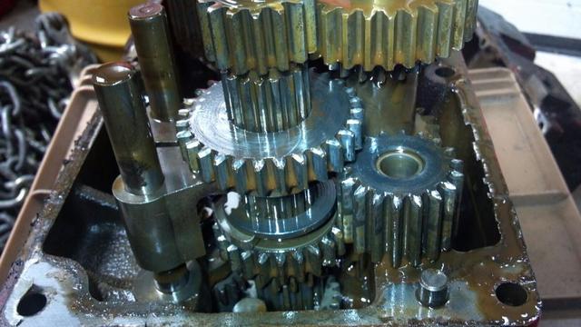

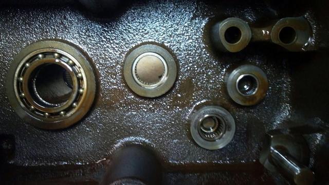

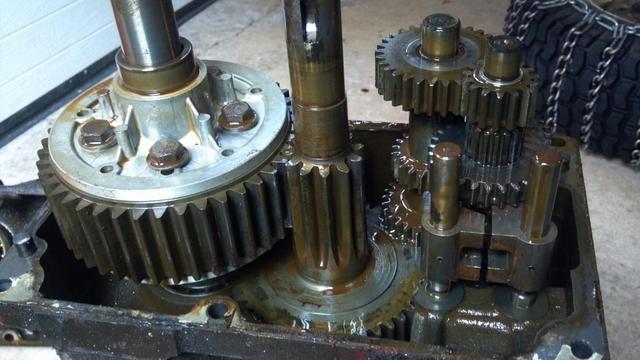

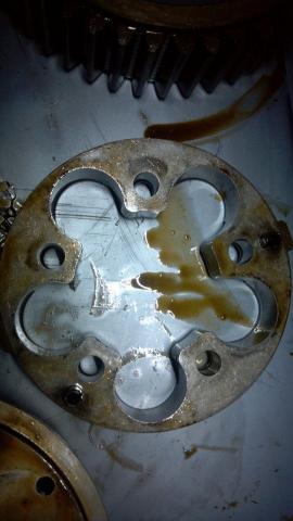

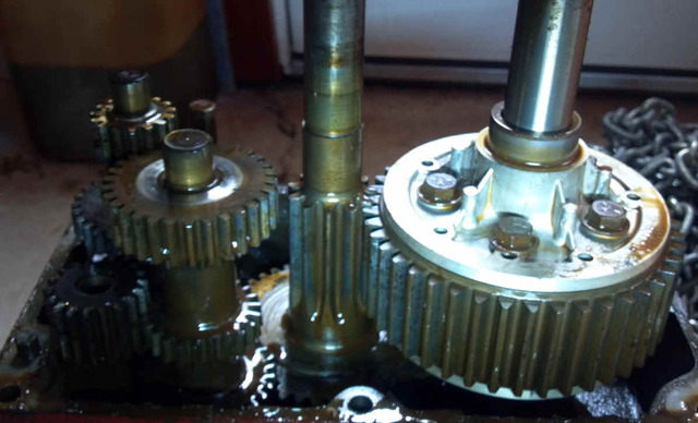

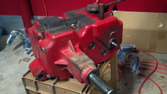

monsstr 35 #13 Posted February 8, 2014 Good afternoon gentlemen, I have finally found the time to work on my tractor. I currently have three things going in my garage, working on my car, my kids motorcycle and now my tractor. Its quite an adventure. I watched your video Steve and while I liked the idea of the wine crate, I don't have one so I used a faux milk crate and cut one of the handles out to allow the shaft to slide through. Works quite well and is sturdy. I took some photos of where I am so far in the process. I do not see any broken teeth so at this point I still don't know why it was jumping teeth like that. Here are the pictures. If I am not getting the proper shots please let me know. I do have to say that I am a little disappointed in myself as I wanted to change the rear oil this fall and other things in life distracted me. No excuses though as this should have been one of the first things I did when I first purchased it years ago. The oil looked like brown runny pudding and Im sure that did not help anything. Thanks Rick Share this post Link to post Share on other sites
monsstr 35 #14 Posted February 8, 2014 Well, Im at a complete loss. No broken spindles no parts out of place that I can tell and everything looks healthy, even the needle bearings.... Im going to clean everything up, reassemble, put in some new gear oil and cross my fingers. Share this post Link to post Share on other sites
TT-(Moderator) 1,173 #15 Posted February 8, 2014 Did you check the differential for internal damage? (pinions, axles gears, etc.) 2 Share this post Link to post Share on other sites

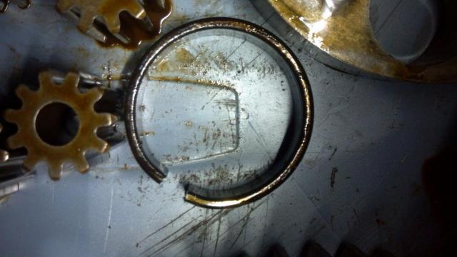

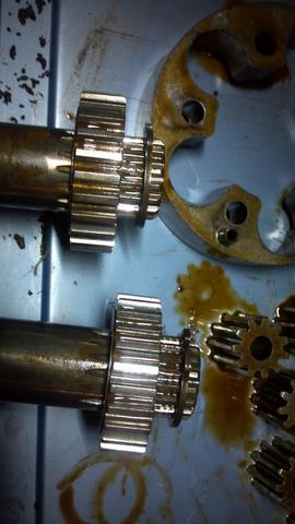

monsstr 35 #16 Posted February 9, 2014 (edited) Yes I did Terry. I apologize as I wanted to post some pictures of that as well. Keep in mind that it looks good to me, as I am just looking for anything broken or out of the ordinary. I will post some pictures of it first thing in the morning as maybe one of you gentlemen will spot something that I have overlooked. Thanks Rick Edited February 9, 2014 by monsstr Share this post Link to post Share on other sites
stevasaurus 23,859 #17 Posted February 9, 2014 Like Terry said...we think the damage is in the differential...you have to lift that out and open it. If you lift it out and try to turn the axles, and you can't or you hear the grinding...you have found your problem. Everything else looks OK. Thanks for the picks. 1 Share this post Link to post Share on other sites
sorekiwi 761 #18 Posted February 9, 2014 That trans looks pretty clean inside compared to a lot of the ones I have seen!! Have a look in the diff, since you haven't found any broken gears in the trans, or bad bearings or bad keys/keyways. Share this post Link to post Share on other sites

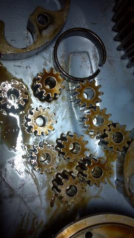

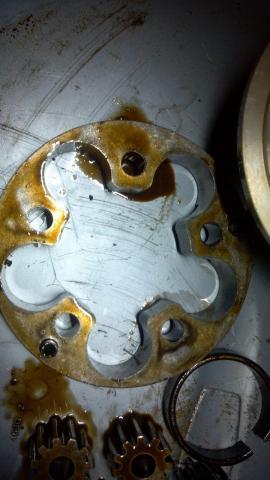

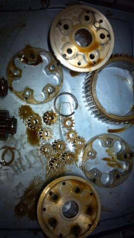

daveoman1966 3,884 #19 Posted February 9, 2014 (edited) Here are pics of the 10-pinion Differential, marked with likely 'failure' parts A (body) and B (spring). There are two A (body) and they commonly crack. I have also seen the spring (B broken and the broken piece of it tears up the pinion gears. The spring END-GAP should be as shown in this pic. (Note that the 2 thrust washers are not in these pics.) NOTE... Use blue loctite on bolt threads when you put this differential back together. Edited February 9, 2014 by daveoman1966 Share this post Link to post Share on other sites
monsstr 35 #20 Posted February 9, 2014 Good morning all, I took a few pictures of the differential and I looked at all the parts very closely especially the ones you noted for me Dave. There are no crack, no broken gears and the spring seems to be just fine. However, I do not have any thrust washers anywhere. Could this possibly be the issue? If you want to to see something specific in a picture please let me know. However that being started, that would have to mean they weren't in there since I owned the Tractor and it has run fine for all of these years. Why would it be an issue now. I do apologize as my tool to remove E clips is missing the one side and I cant seem to find it in my tool box. I really need a bigger tool box. Anyhow, again any feedback would be appreciated. Thanks Rick Share this post Link to post Share on other sites
monsstr 35 #21 Posted February 9, 2014 Just a quick update. I cleaned everything up and went over it thoroughly. Found the washers stuck to the outside of the axle gears so Im good there. So once again I am lost and just cant find an explanation for why the transmission wasn't working properly. Im going to start reassembly unless someone sees something that should be replaced. I did not see anything that I thought looked bad other then the gasket between the case sides. Im willing to replace whatever anyone thinks I should while it is apart. Rick Share this post Link to post Share on other sites

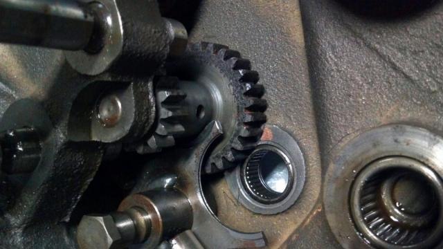

TT-(Moderator) 1,173 #22 Posted February 9, 2014 Did you have anything else apart? Did you happen to try to move (drive) the tractor in low range before you removed the transaxle? If you haven't already been there, I'm thinking you should check the internal splines of the high/low sliding gear and the corresponding outside splines on the input shaft. I'd hate to see you have to tear it apart again. 1 Share this post Link to post Share on other sites

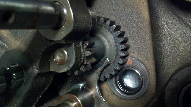

monsstr 35 #23 Posted February 11, 2014 Good evening, Terry, yes I did try it in high and low before I started removing the transmission. I was swamped at work today so I didn't get a lot of time to look closer at everything, but Im hoping maybe tomorrow to be able to do so. I didn't even realize that there were internal splines. Other then the tranny I have had nothing else apart on this tractor. I took two pictures of the outer high low teeth and they look perfect. Again I just wanted to thank everyone for their assistance on this issue. I have learned a lot so far, and its a good feeling. Share this post Link to post Share on other sites
TT-(Moderator) 1,173 #24 Posted February 11, 2014 The gear in your pictures is the high/low cluster gear. My area of concern is the inside of the sliding gear that inserts into the fork in your pictures and the narrow splines on the input shaft that drives the sliding gear. When the transmission is in high range, the sliding gear is what locks the mainshaft into "direct drive", bypassing the high/low cluster gear. The internal splines of the sliding gear: The splines on the input shaft: In high range, the sliding gear locks the input shaft and bypasses the reduction cluster gear: In low range, the power is directed through the reduction cluster gear: The splines that get locked by the sliding gear: Beyond damage to those splines - and if there is no obvious damage elsewhere - I can't think of anything that would cause the symptom(s) you described. 1 Share this post Link to post Share on other sites
