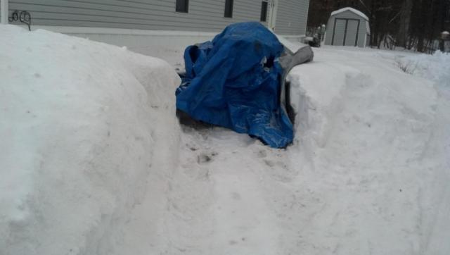

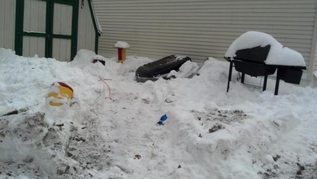

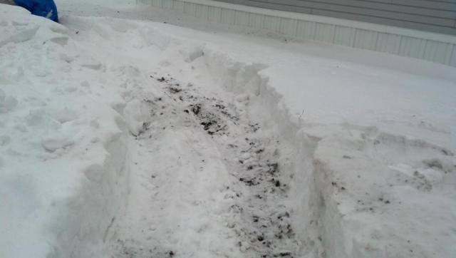

SousaKerry 503 #13 Posted February 7, 2014 (edited) Here are the promised pics the tractor is under the tarp resting up for the next snow. In the last picture this is where we were stuck for two nights Edited February 7, 2014 by SousaKerry Share this post Link to post Share on other sites
