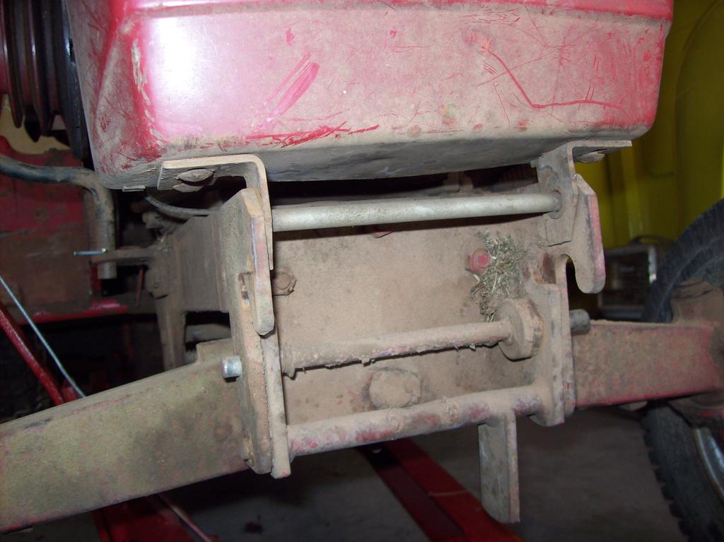

ol550 879 #2 Posted February 5, 2014 Had to make a attachmatic to fit the wider GT 14 frame works great. Share this post Link to post Share on other sites
justnuf 0 #3 Posted January 19, 2018 since you made the bracket to fit the wider frame did you have to adjust the pulley system to make it stick out further to line up with the engine pulley ? Share this post Link to post Share on other sites

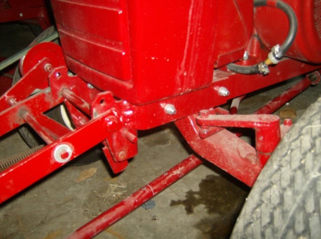

953 nut 69,841 #4 Posted January 19, 2018 Your GT-14 did not leave the factory with a "Tach-a-matic vHitch" on the front and that is what the newer snow blowers connect to. Place a wanted ad here or contact Lincoln at A-Z Tractor to get one. http://a-ztractor.com/ Once it is bolted on the manual will guide you. The frame on the GT-14 is about 1.5" wider than newer units so it should be off center. the one in the photo is on a 418-C. This manual should help. Share this post Link to post Share on other sites
