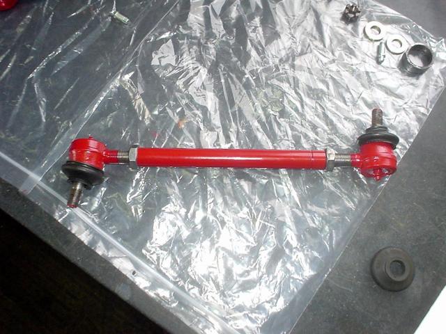

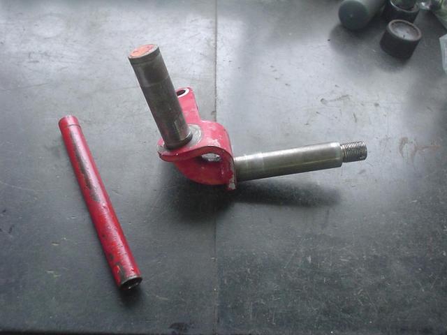

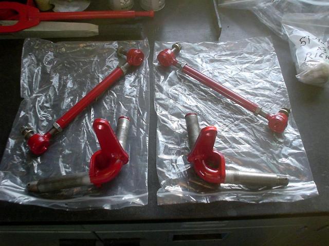

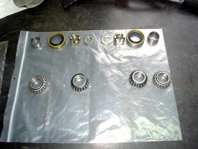

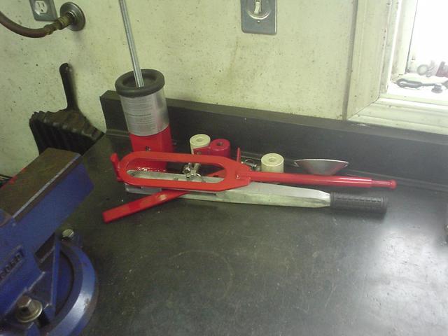

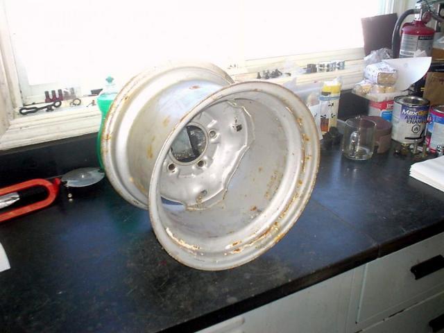

cleat 9,072 #26 Posted February 9, 2014 This weekend was spend taking apart the front end of my 520 with the swept axle. Bearings are all cleaned, tires removed from the wheels. Spindles, axle, tie rods etc cleaned up. Tie rod ends painted. All nuts cleaned up. This is the tool for removing the front tires. Worked perfectly, tires were off literally in a couple of minutes. Now I just need to do some beadblasting and painting then reassemble the front end. Cleat Share this post Link to post Share on other sites

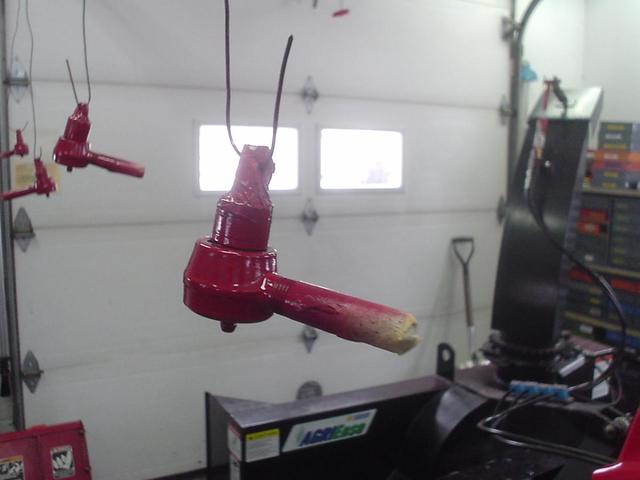

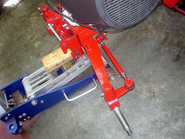

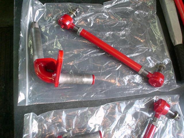

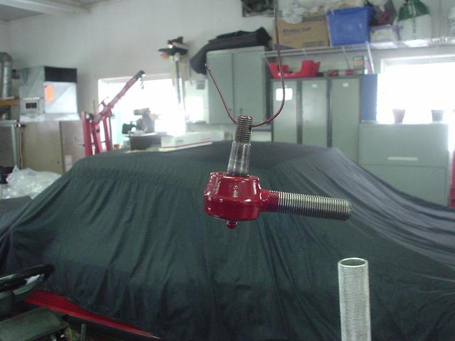

cleat 9,072 #28 Posted February 12, 2014 Front spindles and tie rod tubes bead blasted and painted. Front wheels are underway, pics to follow soon. Cleat Share this post Link to post Share on other sites

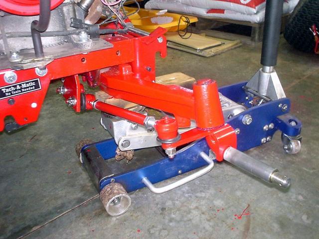

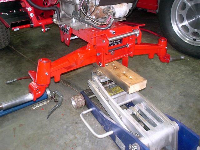

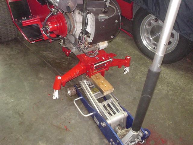

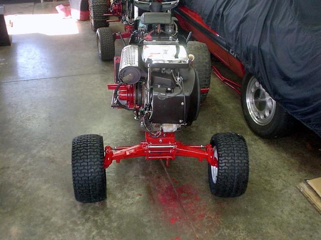

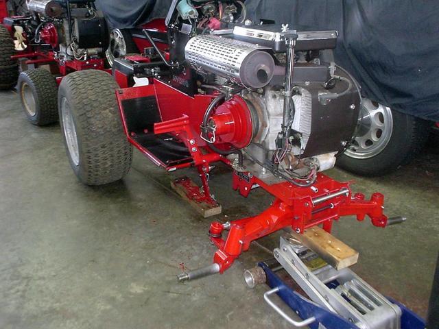

cleat 9,072 #32 Posted February 15, 2014 Front end is starting to come together. Cleat Share this post Link to post Share on other sites

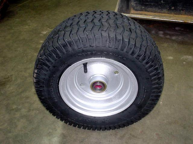

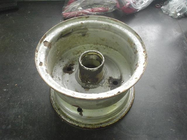

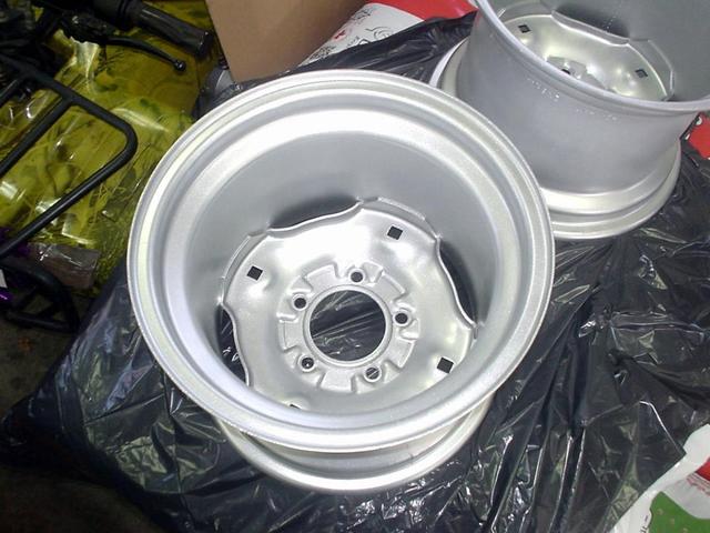

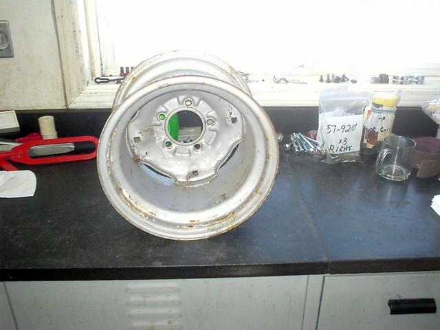

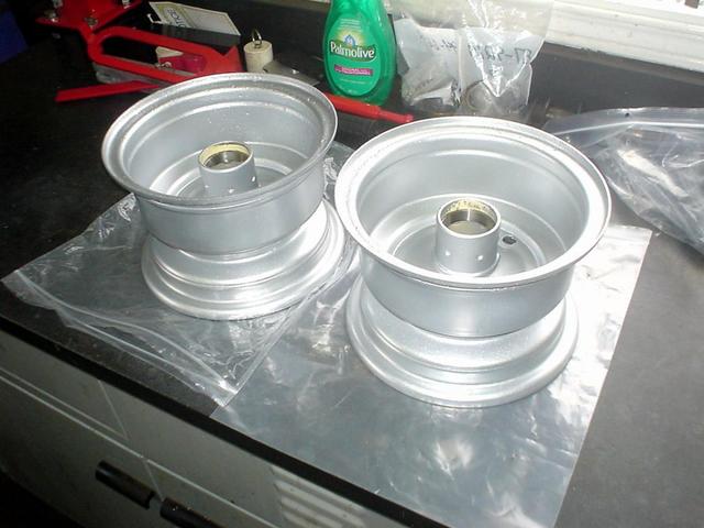

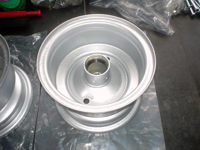

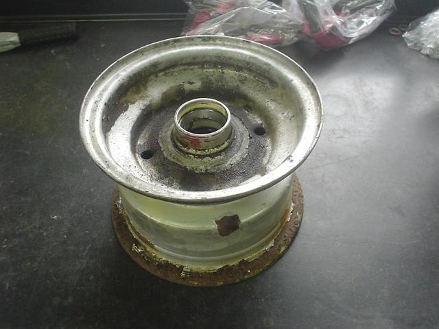

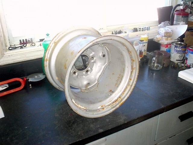

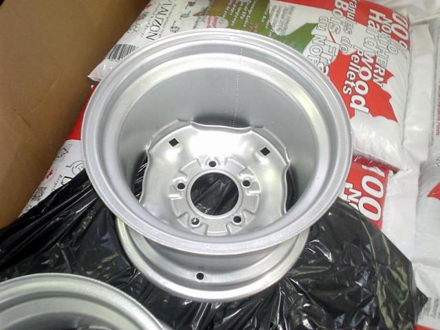

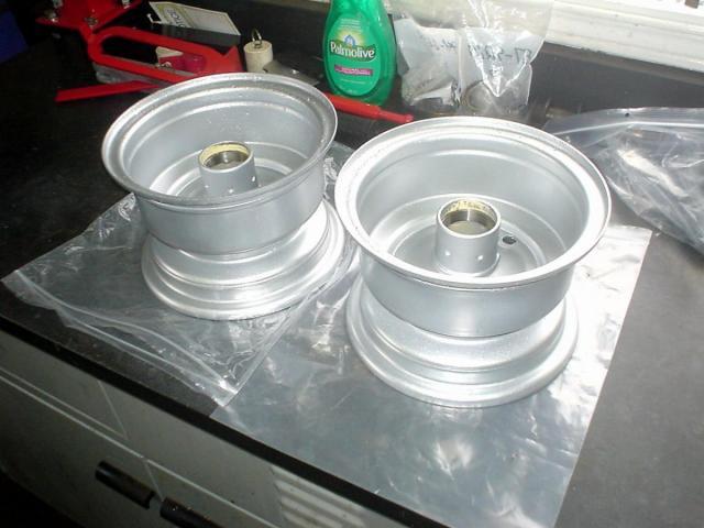

cleat 9,072 #33 Posted February 15, 2014 Front wheels bead blasted and painted. Wheels are pitted so I will be using tubes. I will wait a couple of weeks before mounting tires to hopefully lessen paint damage. Cleat Share this post Link to post Share on other sites
cleat 9,072 #34 Posted February 16, 2014 Removed one rear tire from the wheel using the cheap tire tool. It worked but would work better if the center rod was longer for these 8.5" wide wheels. Only did one because I have one extra wheel and the front is only held up by the jack. Cleat Share this post Link to post Share on other sites

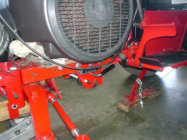

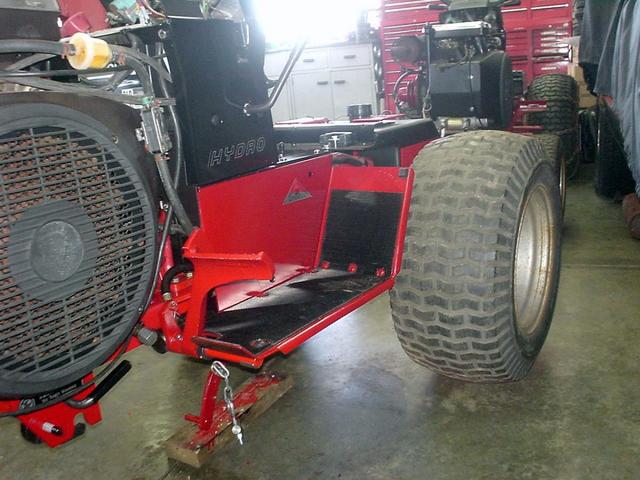

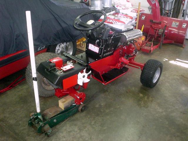

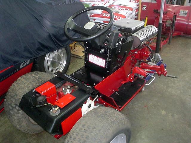

cleat 9,072 #35 Posted February 17, 2014 I spent some more time today putting on more bits and pieces. Here are some general views. I want to wait a little longer before mounting the front tires to allow paint to dry some more. Deck lift rod is also hanging to allow the bellcrank paint to dry. Cleat 2 Share this post Link to post Share on other sites
motox25 36 #36 Posted February 17, 2014 Looking great, were the plastics in that good of shape or did you use something to restore them? Share this post Link to post Share on other sites
cleat 9,072 #37 Posted February 17, 2014 Fuel tank is from Joes outdoor power, Dash is from a person parting a 520 in Ontario. Fuel tank was simply cleaned and polished with Mothers back to black. Dash had some paint overspray on it I removed with paint stripper then cleaned and applied the Mothers. Hydro fan was just cleaned up with spray nine. Foot rest pads are new. Steering wheel was cleand and Mothers applied. All control and Tach-a-matic handles and knobs are new. Fuel lines are new. Thanks, Cleat Share this post Link to post Share on other sites
motox25 36 #38 Posted February 18, 2014 I will definitely be applying some to my badly faded plastics. Thanks Share this post Link to post Share on other sites

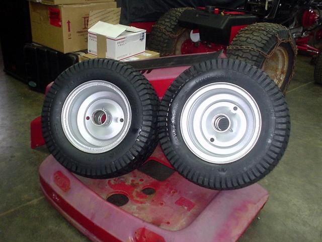

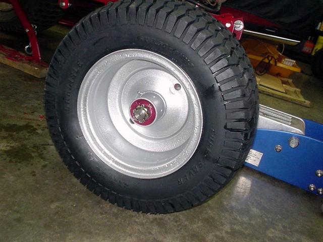

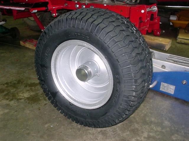

cleat 9,072 #41 Posted February 22, 2014 New front tires mounted on cleaned and painted wheels. Bearings etc cleaned and ready for installation Share this post Link to post Share on other sites

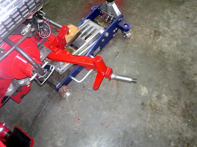

cleat 9,072 #44 Posted February 22, 2014 Membership issue resolved. Front inner bearing and new seal installed. Wheel installed, outer bearing in place and properly adjusted then locked into place with a new cotter key. New hubcap installed. Front view showing front end back together, just needs the alignment to be completed. Picture showing the tractor in it's current state of assembly. 1 Share this post Link to post Share on other sites

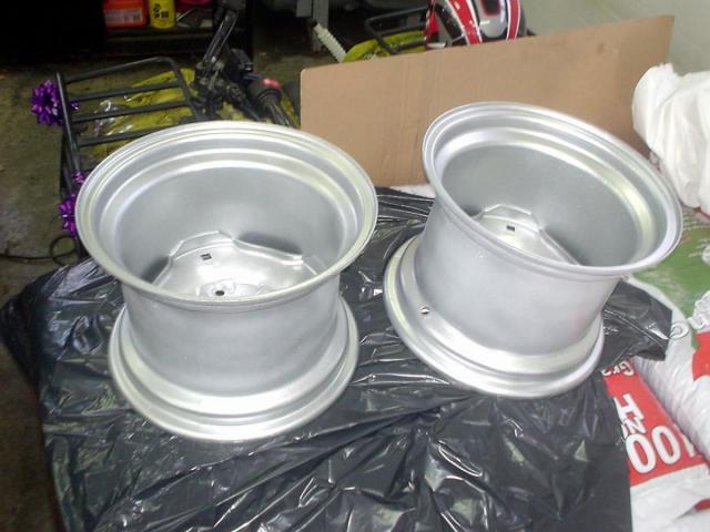

cleat 9,072 #45 Posted February 22, 2014 Rear wheels have been bead blasted and painted. Just have to get the new tires on order then install. Cleat 1 Share this post Link to post Share on other sites

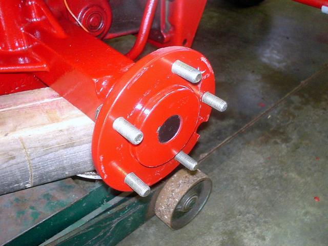

cleat 9,072 #48 Posted February 22, 2014 Installed 5 7/16" x 1-1/2" fine thread grade 8 bolts and flat washers from rear of rear hub to form studs. Now to mount wheel is just like a car, much easier. Cleat 1 Share this post Link to post Share on other sites

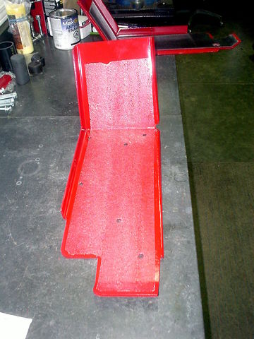

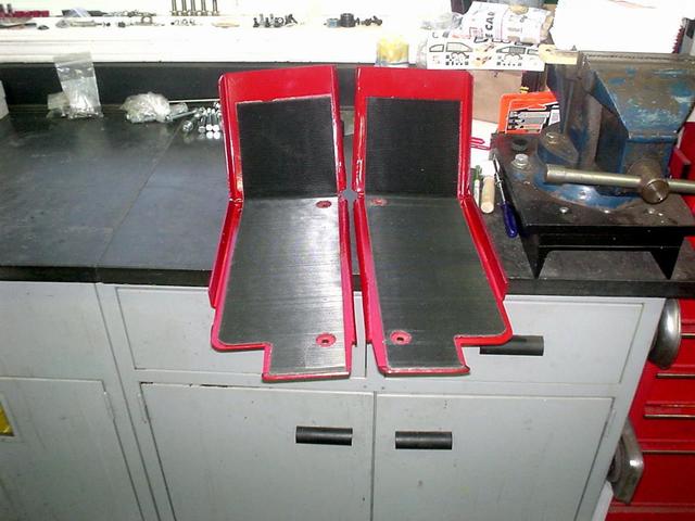

cleat 9,072 #49 Posted February 25, 2014 Finally got the floor mat material for 520 number 2 ( back one in the pictures). Cut it out and contact cemented the rubber mats down. These foot rests were made at my plant years ago since the originals rusted out from too much salt. Cleat 2 Share this post Link to post Share on other sites
