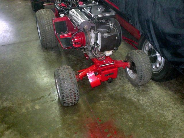

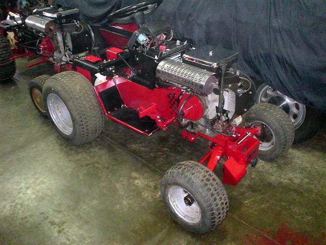

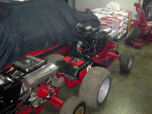

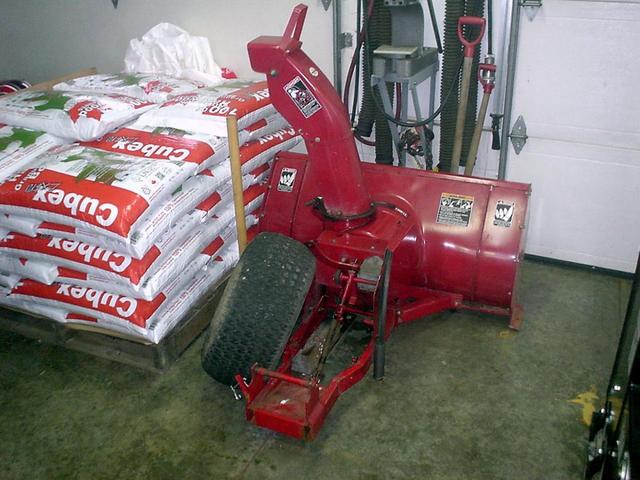

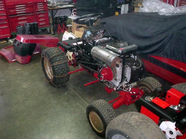

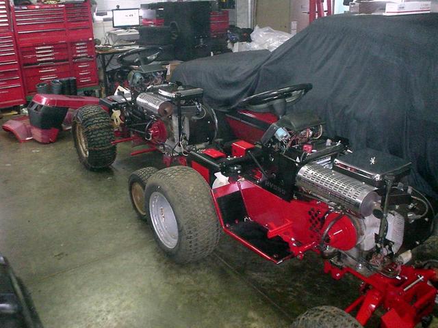

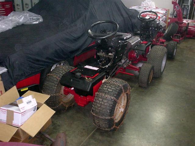

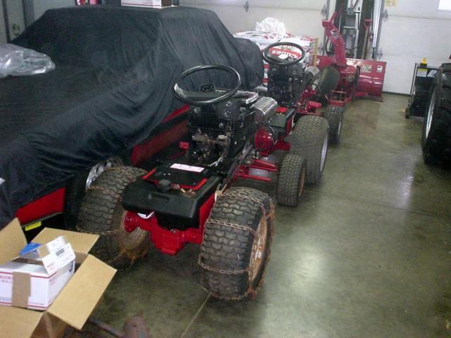

cleat 9,072 #1 Posted February 1, 2014 These machines are about half done. Theay run great now and one has Matt's foot control. Also shown is the snow blower. I also have the 60" mower deck and mid mount grader blade. Cleat 1 Share this post Link to post Share on other sites
cleat 9,072 #2 Posted February 1, 2014 I also have 2 complete decal kits from Terry at Restore your horse and you can see some in these pics. Cleat 1 Share this post Link to post Share on other sites

varosd 1,185 #4 Posted February 1, 2014 nice ventilated belt guard! Share this post Link to post Share on other sites
Forest Road 595 #5 Posted February 1, 2014 Very nice! Sid you rebuild the motors? Share this post Link to post Share on other sites

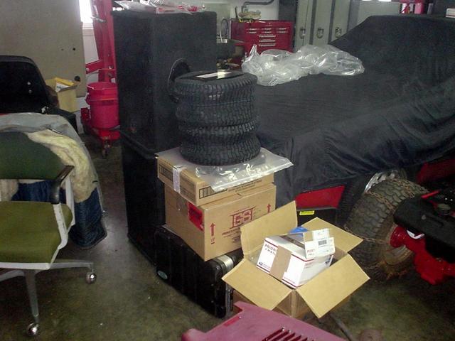

cleat 9,072 #6 Posted February 1, 2014 (edited) The ventilated belt guard is not my idea. I saw a picture somewhere on the internet (likely on this site) and copied it. I used a punch for 1/2" electrical connectors into panel boxed etc that require a 3/8" pilot hole. The end result is a slightly over 3/4" hole. Likely too big as you could get your fingers pinched in the belt but you sure can feel lots of air coming out so it must be a good thing. Tires on the front machine are real bad but I have new fronts as shown and will be replacing the rears soon. Edited February 3, 2014 by cleat Share this post Link to post Share on other sites
cleat 9,072 #7 Posted February 1, 2014 Motors have had the carbs rebuilt, valves set. One replacement head (plug was stripped, used head cheaper than helicoil set), one new coil, one new fuel pump, one new regulator, one set of ignition wires. They now run good, no knocks no smoke. One machine has about 360 hrs, of snow blower only use, the other around 650 of unknown but I think mower mainly use. Cleat Share this post Link to post Share on other sites

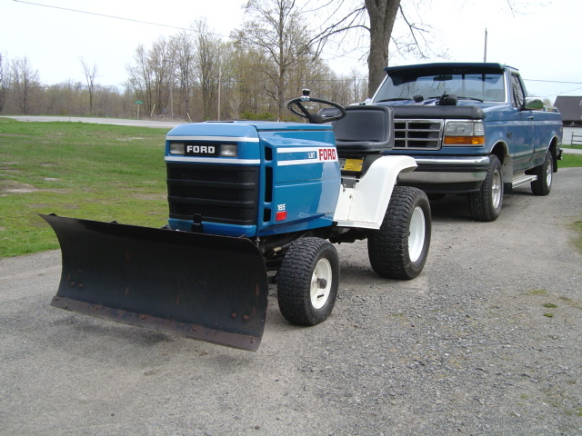

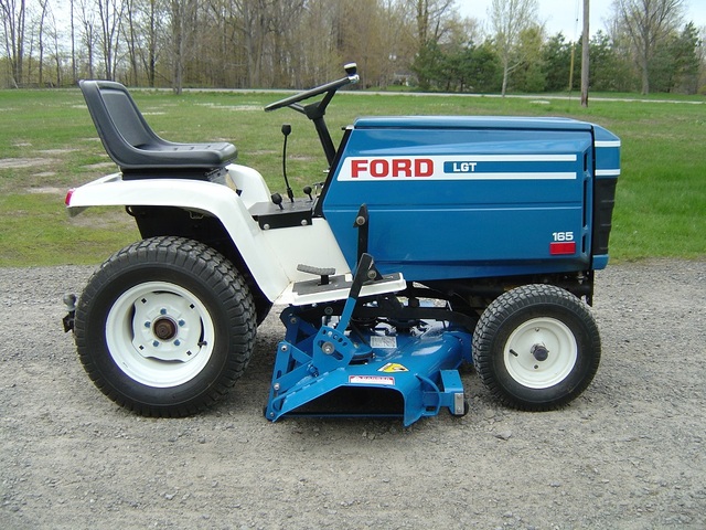

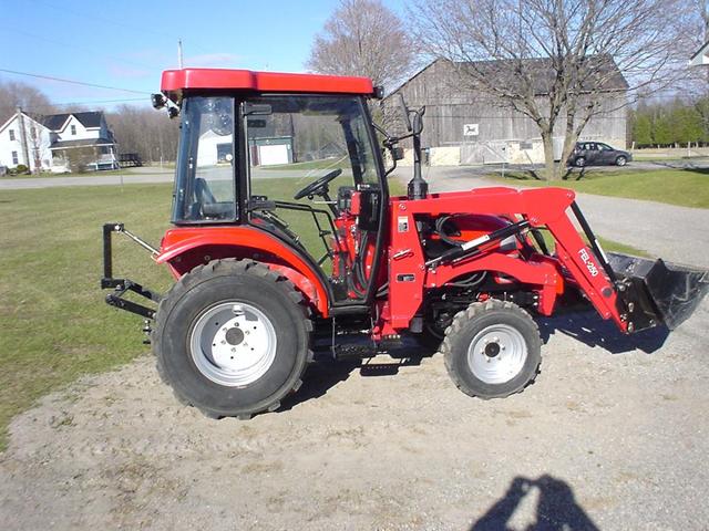

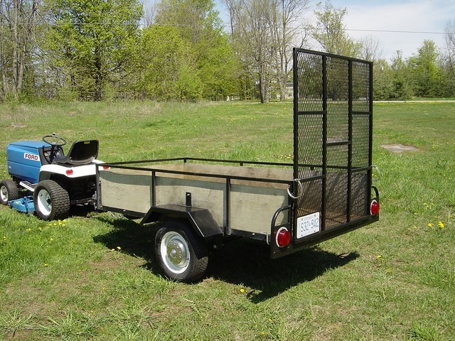

cleat 9,072 #18 Posted February 2, 2014 Now I am going way off topic but here are more of my toys: Ford LGT165 with 42" mower deck. Ford LGT 165 with front blade. 2011 DongFeng 30HP diesel 4X4. 1985 Merkur XR4Ti. 1 Share this post Link to post Share on other sites

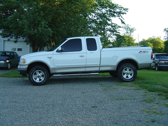

cleat 9,072 #19 Posted February 2, 2014 My tow vehicle. 2002 F-150 Lariat 5.4l. Trailer for the horses etc. Cleat Share this post Link to post Share on other sites

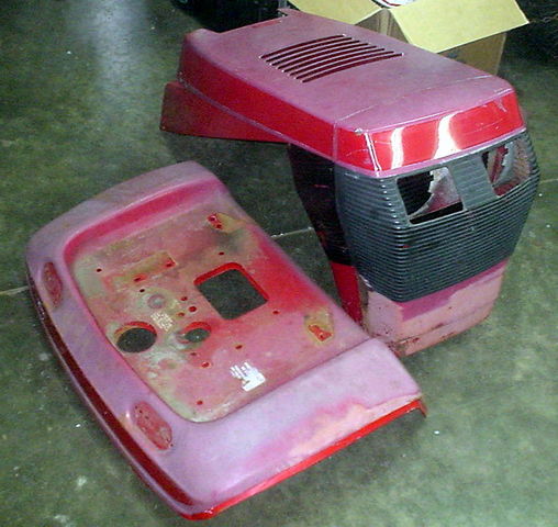

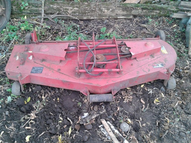

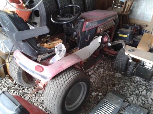

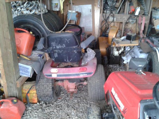

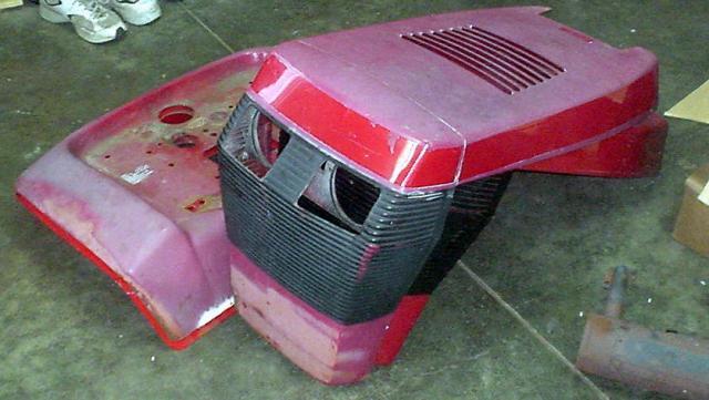

cleat 9,072 #22 Posted February 2, 2014 This is out of order as I just found these pictures. I took these at the farm where I bought the poor thing while waiting for the owner to arrive. These are some pictures of the 520 I bought for the 60 inch deck and grader blade. I don't have a picture of the blade but aside from some surface rust it is perfect. In the pictures at the start of this thread this is the rear machine as it started out. Poor deck was laying upside down in a heavy horse pasture. Seems to be in good shape, all pulleys turn nicely, no holes. Cleat Share this post Link to post Share on other sites
