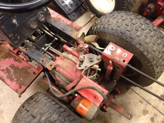

Martin 2,134 #11 Posted January 31, 2014 Looking this up by model it could be a 93,94,or 95 serial number dates it to 95. What transmission would this have? Eaton 700 or the 1100? It has a filter that is inline, not mounted to transmission. What else would I need to ID the trans? by your description of the filter you have an 1100, that is what they came with. this is the eaton 1100 in my 92 416H.... Share this post Link to post Share on other sites
leeave96 496 #12 Posted January 31, 2014 Hydro with a manual lift would indicate an Eaton 700 tranny in addition to the absence of a tranny filter. Share this post Link to post Share on other sites
