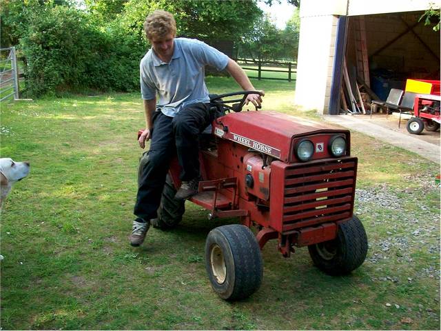

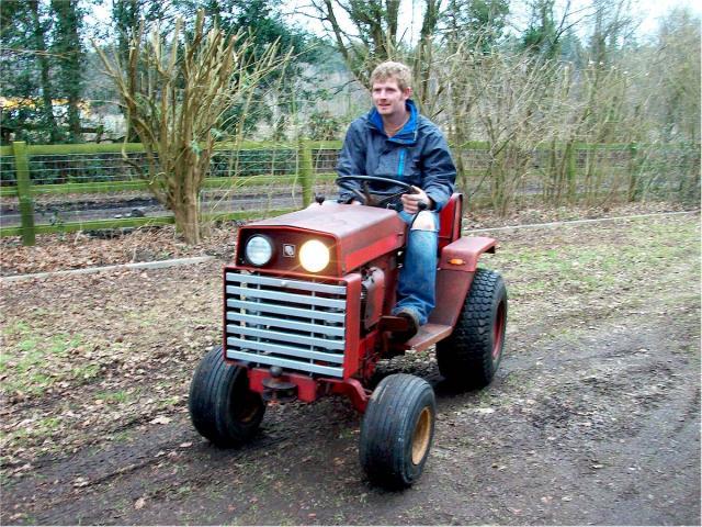

wheeledhorseman 579 #6 Posted January 28, 2014 I do indeed have two Ds Charlie. Not satisfied with a double C I had to achieve a double D. Here's the first having just been unloaded from the trailer as a new arrival. My son is driving. Many hours and many pennies later it looked like this...... This is the second D, again photographed having just been unloaded. It's just the basic model with no 3-point or turning brakes but it does have a ball hitch front and rear and I got it as a yard tug to move trailers in and out of the tight storage space before hitching up to a vehicle. I'm not in any rush to restore this one as it has (to me at least) a certain charm the way it is. The first one I saw on ebay was I think a D-180 but I was just looking at that stage. The first I bid on was a D-200 with 3-point but it went for more than I thought I was prepared to pay. Still kicking myself several years later as that one had a 3-point and pto driven flail mower / topper to go with it all in working order. My guess is that it went to someone with a paddock to mow rather than to a collector but could be wrong. There were a pair of D-200s offered for sale (one running, one for spares or repairs). Expressed interest twice but negotiations led nowhere. Also expressed interest in what I think was a D-160 that had been laid up in a garden for a few years but ran when it was parked up. Made an offer when there were no bids but my offer wasn't accepted. It's worth making offers though on Ds that don't attract bids - that's how I got the second one above. There was also a D-200 that appeared for sale on you know where, it was in Wales I think. Nice tractor with belly mower and 3-point with pto driven rotavator. Nice guy selling it, we talked for a while on the phone. I thought it was pricey and didn't bid but on reflection (again) Ds with 3-point and OEM pto driven attachments are very rare. Finally, a couple of words of wisdom - before considering a D project be prepared to get parts shipped from the US and be aware that the 3-point is Cat 0 as are the front & rear PTO couplings. The PTO speed is also too high for modern attachments, you'd need a reduction gear box of some sort. Andy p.s. I think I have a couple of photos of ones that got away - I'll take a look and post here if I have. Share this post Link to post Share on other sites

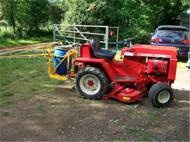

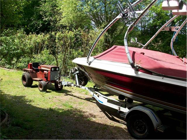

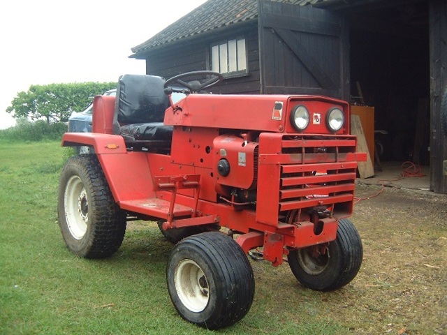

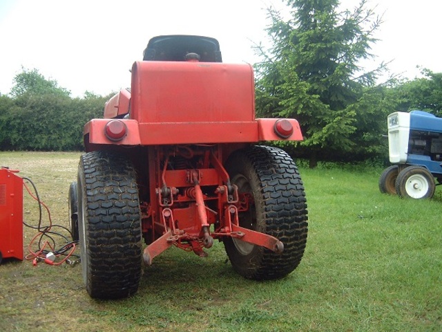

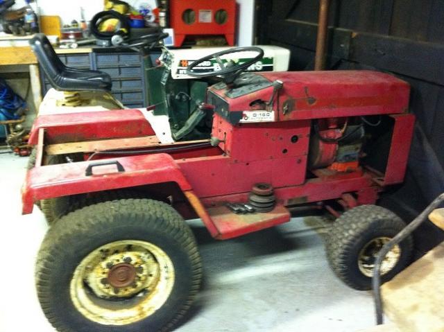

reeman-uk 5 #13 Posted January 31, 2014 I have searched through my pictures (I think I have more picture of my tractors than I do my kids) and my two D-series appear to be a little camera shy. If I have done this correctly I should have attached two pictures of my D-200 and one of the D-160. Warning - two of the pictures also contain another brand of tractor Iain 1 Share this post Link to post Share on other sites
Anglo Traction 761 #14 Posted January 31, 2014 Thanks for taking the trouble to post the Pics Iain . No problem with the other coloured ones (though I think there maybe an aversion to Green and yellow on the Main Forum?). The D200 look's impressively well equipped. Always happy to see your other Tractors in the Other Brands Section if you have the time. Regards Share this post Link to post Share on other sites

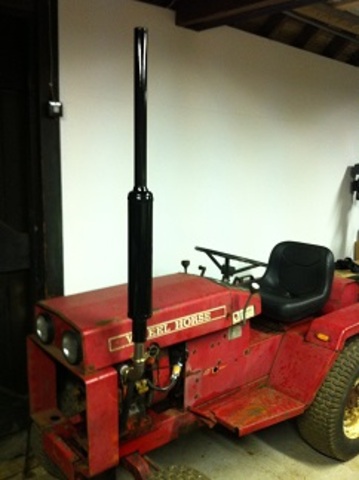

reeman-uk 5 #15 Posted January 31, 2014 I just found a picture of the exhaust I put on my D-160. This was before the flipper got added to the top and the home made manifold got painted. It sounds great and is not really as tall as it looks in the picture. I added a brace to remove any stress from the exhaust port. I now need to do the same on the D-200 or find a cost effective altervative to the standard exhaust. Double the cost on the D-200. I was once told by someone in the US that a B&S exhaust is a good alternative but they never gave me the part number. Iain Share this post Link to post Share on other sites

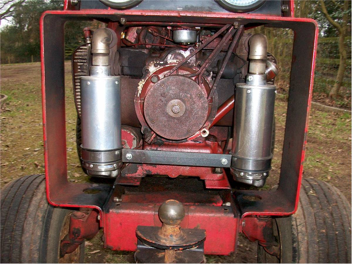

wheeledhorseman 579 #17 Posted January 31, 2014 That's some stack you got there! Here's a cost effective solution that PO of my second D came up with. using a couple of dirt bike cans. They sound awesome when you open the throttle! Mark can testify to this. The engineering needs a bit of tidying up and a couple of down pipes added so they don't soot / scorch the grille frame but I decided no rush at present as the paintwork is very tatty anyway. I need to sort out something for the restored D soonish as one of the cans on that one is now held together at one end with paste where previous weld repairs have now given up. A guy in the US was advertising some OEM cans a couple of months back but the cost of shipping them put me off and I have in mind making some new cans to slide over the existing through pipes which seem solid enough. There was a long debate about other cans that would fit on the forum but turned out that dimensions given in the technical sheets was wrong and the cans were to long to fit inside the grille frame. I'll try and locate the thread. Andy Share this post Link to post Share on other sites
meadowfield 3,189 #18 Posted January 31, 2014 That's some stack you got there! Here's a cost effective solution that PO of my second D came up with. using a couple of dirt bike cans. They sound awesome when you open the throttle! Mark can testify to this. Andy Still smiling now :D Share this post Link to post Share on other sites

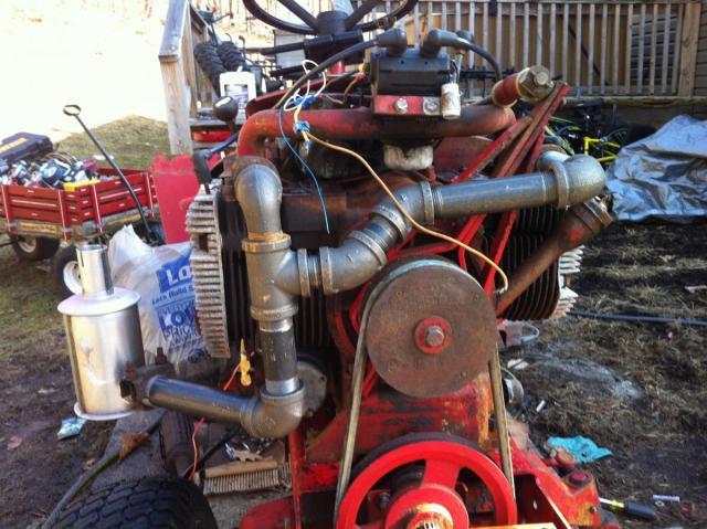

wheeledhorseman 579 #19 Posted January 31, 2014 I guessed you'd not have forgotten the experience Mark Iain, here's another solution by Jeff (hodge71) photo from his resto thread on RS I've seen this type of plumbing a couple of times on the forum. Andy Share this post Link to post Share on other sites
reeman-uk 5 #20 Posted February 3, 2014 Andy, The older I get the quieter I like my tractors. The exhaust I have on the D-160 makes it sound like a full size tractor and does not really look as odd as the picture suggests. I will take a better picture one day. The one I posted was taken looking down on the tractor which makes it look very large. This may be old news for D-series owners however just in case it is not. I needed to rebuild the steering box on my D-160 as it was even more sloppy than usual. I priced the parts in the US and had a bit of a shock. I then did lots of research and found that the same steering box is used on a smaller tractor of the green and yellow variety. I went to the local dealer and bought the parts over the counter for not a lot of money. I am now looking forward to doing the same on the D-200 when I get the chance. I forgot to mention that I have a love/hate relationship with my D-200. I love it and each time I spend lots of time getting it working well, it dies soon afterwards and has to be dragged back to the workshop. For the moment it is parked in the dark at the back of my storage building surrounded by tractors of a different brand, so it can think about its behaviour. Iain Iain Share this post Link to post Share on other sites

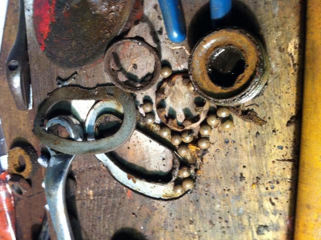

reeman-uk 5 #24 Posted February 4, 2014 The steering on my D-160 worked fine but was sloppy and it was interesting to keep it in a straight line at full speed, so I thought that rather than adjust it I would take the steering box apart and do a full refurbishment. The attached picture is what I found inside the steering box. As a rule of thumb, if your D has ever been left outside for a while and the top steering column bush is warn, yours will probably look the same. I found that the same or similar steering box was fitted to a number of JD’s and the ones I found were 140, 216 and 300. I have no idea what these tractors look like. If you really want to impress the JD parts person these are the part numbers you need: M45567 – Stud (the bit that turns the steering arm) AM31924 – Bearing kit which includes 2 races, 2 ball sets and 2 retainers (ball sets are essental for driving a D a full speed!) Optional bits are M45568 – Isolator (the large D shaped spacer) M43747 – washer (that fits under the race) A quick Google for any of these part numbers is likely to give you a JD parts diagram. Note. these diagrams may not look like your WH part but I think that is a problem with the diagrams not the reality. The job does not take very long, so no excuses for sloppy steering on your D To finish the job I fitted thrust bearings between the front axle and steering spindles to give me poor mans power steering. I would be really interesting in knowing the parts to fit for proper power steering. Iain 1 Share this post Link to post Share on other sites
wheeledhorseman 579 #25 Posted February 4, 2014 (edited) Top post Iain! You're inspiring me to go out and get the bits ready to do a proper job when I get time. Re power steering - I'll do a search on the forum as I'm sure I m not imagining this but sometimes finding a particular thread from the past isn't easy to find. Andy [edit] - easier to find than I thought - it was the steering unit from a JD 420 - the thread is here: Inspiration for us both perhaps? Andy Edited February 4, 2014 by wheeledhorseman Share this post Link to post Share on other sites
