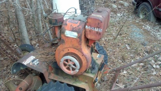

Wheel-N-It 2,978 #12 Posted January 29, 2014 I actually stumbled across a big single cylinder wisconsin engine late this afternoon. I was at a friends house getting a speedometer out of a junk chevy dually truck to replace the broken one in mine when I found an old walk behind ditch witch in the edge of the woods with the engine still attached. The engine was not siezed, and it did seem to have compression. I took a pic of it to show you guys, and will post it tomorrow when I get back to my office. Its one big tall son of a gun! That thing on a Wheel Horse would pull the heck out of a plow! Share this post Link to post Share on other sites
Wheel-N-It 2,978 #13 Posted January 29, 2014 Here is the engine I found yesterday. This thing is a Beast ! Share this post Link to post Share on other sites

SousaKerry 503 #15 Posted January 29, 2014 We had that same engine on a piece of farm equipment when I was a kid the thing would idle all day powering the small tractor no problem. They are also very quiet for a motor that size. That big rope start pulley on the front will also work with a Starter Generator setup, someone who owned it before us had rigged up one off an old Briggs motor and it worked very well. 1 Share this post Link to post Share on other sites
Wheel-N-It 2,978 #16 Posted January 29, 2014 I'm pretty sure I can talk my friend Doug into selling the whole piece of equipment to me. Might take a little time though, I just got to feel out the situation. His Dad is the person I bought my 416-8 from. Anyway, I'm thinking Wisconsin engine, tall & narrow AG tires on the rear, tri ribs on the front, pan seat and bare bones rear fenders............................................ 1 Share this post Link to post Share on other sites

farmerall 23 #20 Posted January 30, 2014 Here is the engine I found yesterday. This thing is a Beast ! That is most likely an AENL or AENLD engine on there and you're right it is a beast. Wisconsin engines are known for being heavy and having lots of torque. Heck I had a 2-2.5 hp Wisconsin. That engine weighed at least 60lbs and was considerably larger than an aluminum Briggs 3.5 hp engine. 1 Share this post Link to post Share on other sites
Wheel-N-It 2,978 #21 Posted January 30, 2014 I have this old school Wisconsin Horse in my collection. It is a highly modified 1964 WH from way back in the day. Looks kind of cool but not really if you are a purist! I left it that way just for shits and giggles!http://i1023.photobucket.com/albums/af352/Hammerhead43074/100_7561_zpsc8d65dcb.jpg Thank you for posting the pic. Its good to know the S/G setup will work on one of those engines. Pulling a starter rope might be OK once and a while but not every time. That is most likely an AENL or AENLD engine on there and you're right it is a beast. Wisconsin engines are known for being heavy and having lots of torque. Heck I had a 2-2.5 hp Wisconsin. That engine weighed at least 60lbs and was considerably larger than an aluminum Briggs 3.5 hp engine. Thank you for the information. I'll be sure to check into this further. I really want to be able to save this engine from the scrap yard. I don't know how much this engine weighs but it looks alot heavier than any K341 ever was. Any ideas on the weight of this thing? Share this post Link to post Share on other sites

farmerall 23 #23 Posted January 30, 2014 Thank you for the information. I'll be sure to check into this further. I really want to be able to save this engine from the scrap yard. I don't know how much this engine weighs but it looks alot heavier than any K341 ever was. Any ideas on the weight of this thing? The engine weight is around 110 lbs if it's an AENL. 1 Share this post Link to post Share on other sites
Wheel-N-It 2,978 #24 Posted January 30, 2014 The engine weight is around 110 lbs if it's an AENL. OK, well then maybe I won't have to buy a engine hoist should I transplant this thing. That'll save me a few dollars. Share this post Link to post Share on other sites
