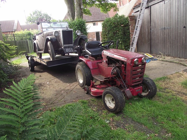

post-4525-0-87949600-1391009053_thumb.jp My C101 has no problem with my old cars or the same trailer loaded high with logs.As most of the towing is done on a sloping grass site I keep the wheelhorse in low ratio and have the trailer over run brake engaged and it has not "got away" from me yet.I also use it to pull dinghys up the slipway at the end of the garden but sometimes it starts to spin it`s wheels and I have to resort to a winch powered by the wheelhorse battery with the tractor fastened to a tree with a rope sling!.

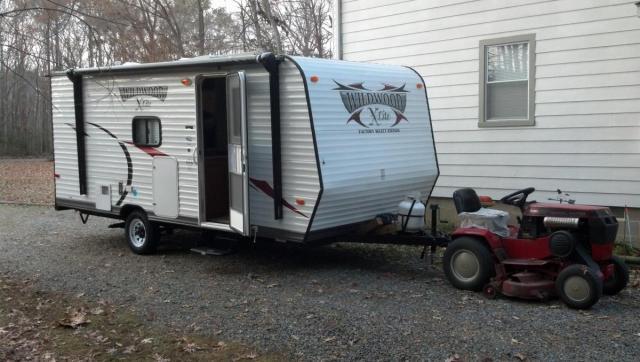

I move my boat around flat paved surfaces with 416H all the time without an issues.  Total weight of the rig shown is probably close to 3500lbs.  I do keep the trailer jack wheel close to the ground in case something goes wrong, but it hasn't....yet.
post-3074-0-06630900-1405890630_thumb.jp
What is the tongue weight of that boat? I've been moving my camper around with mine using a rear hitch but want to do something different, like what you have there. Tongue weight of the camper is 400 ish and total weight is 3000. I was curious how much weight the attach a matic and the hitches made for them could handle.
