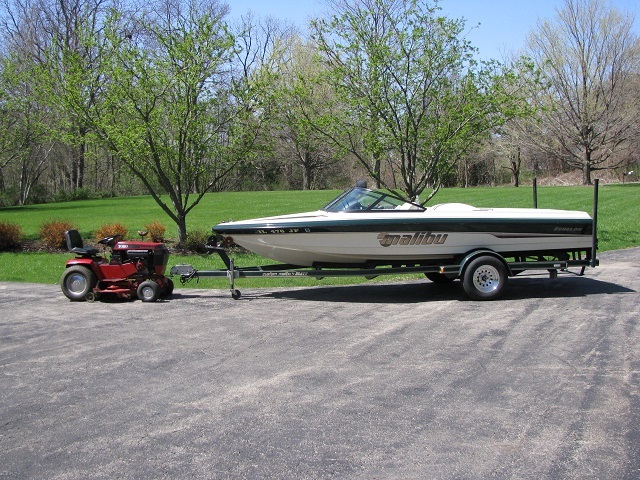

Sethro 4 #10 Posted January 25, 2014 I move my boat around flat paved surfaces with 416H all the time without an issues. Total weight of the rig shown is probably close to 3500lbs. I do keep the trailer jack wheel close to the ground in case something goes wrong, but it hasn't....yet. 2 Share this post Link to post Share on other sites
