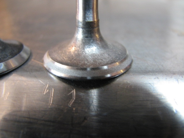

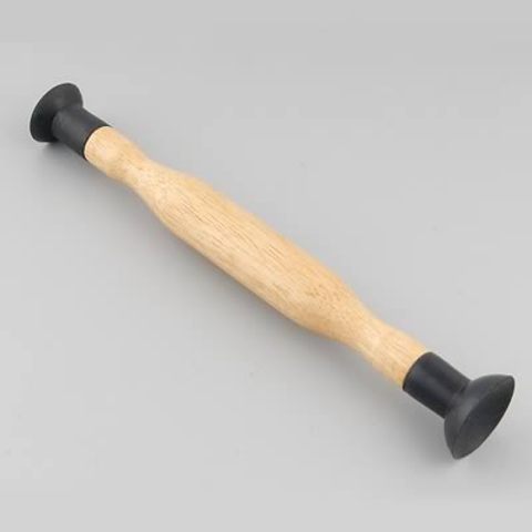

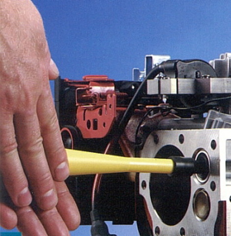

rmaynard 17,642 #3 Posted January 24, 2014 Lapping valves is the process whereby you create a matching surface between the valves and the valve seats. As the engine runs, the surfaces of the valves and the seats will wear. Sometimes it's bad enough that both the valves and the seat need to be ground. This is done at the machine shop unless you have the equipment, and if you did, you probably wouldn't be asking this question. Sometimes the valves need to be replaced. However, if your situation is such that all you need to do is "lap" them, that is done with a lapping tool: and valve lapping or grinding compound. The process is done by attaching the suction cup to the top of the valve, applying a small amount of compound to the underside of the valve, applying a small downward pressure while spinning the lapping tool between your hands. As Jrblanke said above, it is well covered with many videos on YouTube. A finished lapped valve will look similar to this. 2 Share this post Link to post Share on other sites

oldlineman 1,820 #5 Posted January 25, 2014 Thanks Bob that is about what I had in mind but thought you needed some sort of mechanical equipment, a simple peace of wood with a suction cup on it is very basic and simple. Great pictures and instruction, after that I think I could do it. Thanks again! Bob Share this post Link to post Share on other sites
