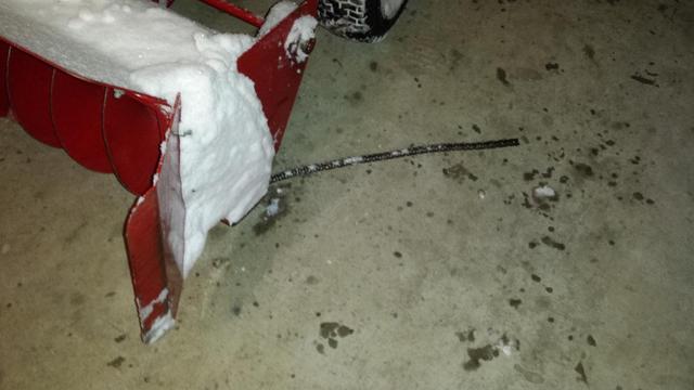

JERSEYHAWG / Glenn 4,487 #1 Posted January 21, 2014 What a start.. go out on the 416. Rigged and ready. Don't even finish the first pass. There's a couple baseball size goose egg stones in the driveway. The Mrs drove off the driveway coming home. The rest of the story you can guess. I am soooooona mad. Grrrrrr. I have a toro dealer a mile away. Hope he has a chain. Hope the auger is ok. We were unstoppable. Glenn Share this post Link to post Share on other sites

smoreau 658 #3 Posted January 22, 2014 (edited) #40 roller chain, buy in bulk and change every few years. lube it with some oil a few times during the snow season also. Edited January 22, 2014 by smoreau Share this post Link to post Share on other sites
Sarge 3,462 #4 Posted January 22, 2014 Amen , just get a box of #40 roller chain and a few half/repair links as well as a few master links . I've repaired my old box style one and even had to cut and replace the auger sprocket due to rocks jamming it . Nice part making your own stuff - you can re-gear the ratio a bit , mine throws snow into the next zip code . Need to upgrade the auger's internal bearings to a heavier style - the OEM's aren't designed for that rpm's . Sarge 1 Share this post Link to post Share on other sites
WH nut 553 #5 Posted January 22, 2014 Count the links if you have all the chain Share this post Link to post Share on other sites

JERSEYHAWG / Glenn 4,487 #13 Posted January 22, 2014 (edited) Count the links if you I just counted the links,,,52. Bulk chain, normally 10 ft. length is pricey,,from 25 to 50 bucks on a quick search today,,not counting the price of master links,,half links,,,anyway not done with this yet. Spent today with walk behind,,and shovel doing the mop up work,,we got a total of 12 inches plus drifts. Darn it,,,,I really missed my wheel horse fun time. Thanks for the comments guys. Glenn Edited January 22, 2014 by JERSEYHAWG / Glenn Share this post Link to post Share on other sites
Rick_in_CT 156 #14 Posted January 23, 2014 10 feet should run about $20. NAPA around here is $18. When you make up the new chain, take five more minutes to make up your "spare" chain. I take the second one and put it in a zip lock bag with a couple of extra master links. I know that the chain will never break unless its freezing cold and I have a lot of snow to move. The last thing I want to do at that time is count links and cut chain. Keeps the blood pressure a little lower when the @#%& hits the fan. It's cheap insurance. You did better than us, I only got about 6" here in CT. 5 Share this post Link to post Share on other sites
dwayneGT 6 #15 Posted January 23, 2014 And remember,don't over tighten the chain either it's not like tightening a v-belt the chain needs a little play. you'll wear out the sprockets faster and the auger sprocket is welded on. Share this post Link to post Share on other sites
Forest Road 594 #16 Posted January 23, 2014 Do yourself a big favor and inspect all bearings and sprockets. Probably time to replace them. Teeth on chain drive equipment, bicycles too, gets worn to a sharp point by worn out chains. For the price of chain it's cheap enough to slap a new one on every couple of years. Versus all new sprockets. Share this post Link to post Share on other sites

JERSEYHAWG / Glenn 4,487 #18 Posted January 24, 2014 Just a fwiw. Found a local place. Actually a old wheel horse dealer 55 years in business. Makeing a chain for my snow thrower $50. Glenn Share this post Link to post Share on other sites

JERSEYHAWG / Glenn 4,487 #22 Posted January 24, 2014 (edited) For 50 bucks I would make them all day long. Me to,,,,,LOL. That gave me a good laugh. I got a call from the shop before, right before they were closing. Rob the owner says Glenn will have it done tomorrow around ten, come and pick it up. Will let you guys know the final bill for laughs, I am darn sure NJ sales tax will get added to that $50. Glenn Edit: plus i want to add this. I dont have the correct tools to do the job. Never did a chain before. If I see them ever at the flea market or something time to buy them. With Wheel Horse ownership I can see differant tools being added for things. Right now in winter just want the snow thrower up and running again. Thats tomorrows chore. Edited January 24, 2014 by JERSEYHAWG / Glenn Share this post Link to post Share on other sites
Rick_in_CT 156 #23 Posted January 25, 2014 Hi Glen, If you have never done a chain before, save the old one and you can practice on it. All you need is a vise (to hold the chain), a file (to remove the head of one of the pins), a nail (to drive out the pin), and a hammer (to hit the nail!) and you can get the job done. I didn't look, but there are probably videos on youtube on how to cut chain. If you do it a couple of times you can get pretty good at it. For now, pay the man and get the machine up and running, you don't want to miss out on any seat time. Rick Share this post Link to post Share on other sites
